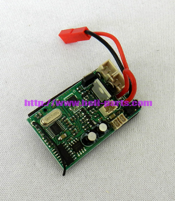

Hello and greetings from Germany.
You make since crazy
quite big cinema with the Devos . Thanks a lot for this!!!
I have a helicopter to get though without remote control
How do I get out now with what protocol it connects ???
The manufacturer is " Acme Zoopa 350 " there are also other are the same . Since we have " Vitality Mad Speed" and " Xiong Xing D9025 " .
The all have the same board there. " HY JJH20 - RX " .
anyone have a suggestion
Many Thanks...

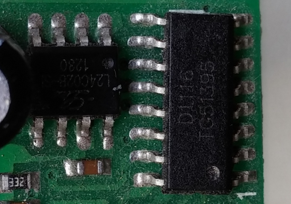

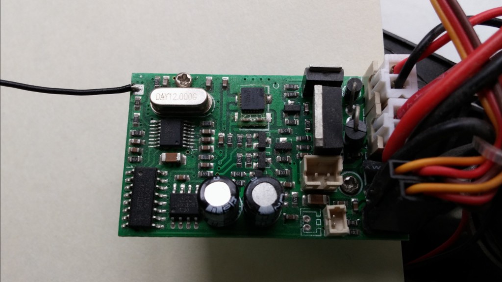

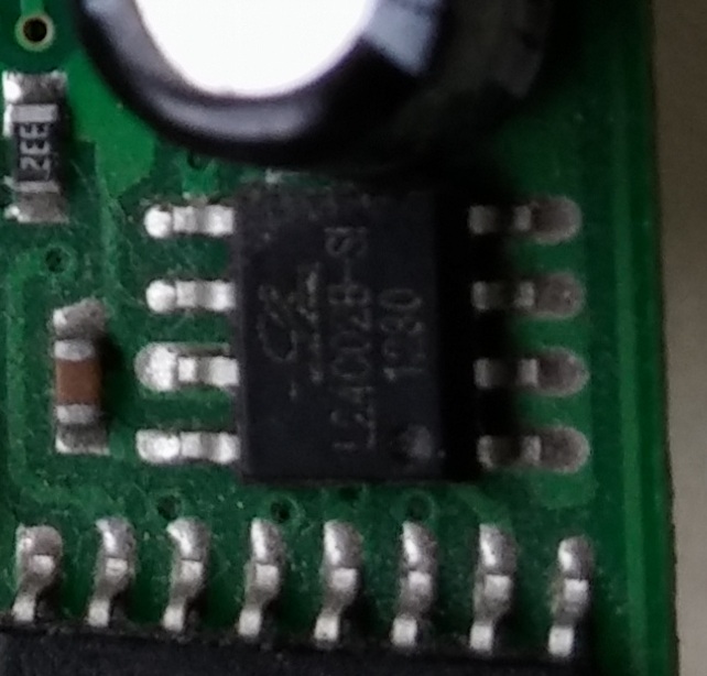

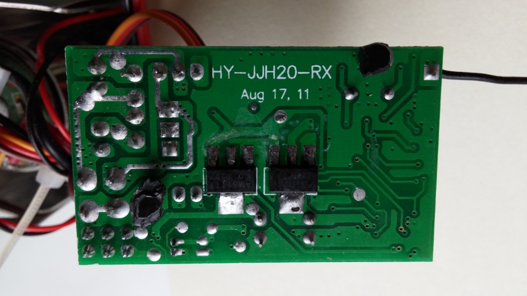

Can you post a clear close-up photo of the Receiver board? Also, you star that the board is the same, but can you control them all with the same remote control transmitter?

I'm not sure there .
but they all have the same remote control .
the board are similar very .
I'll try but I do not know exactly which chip the chip receiver should be.

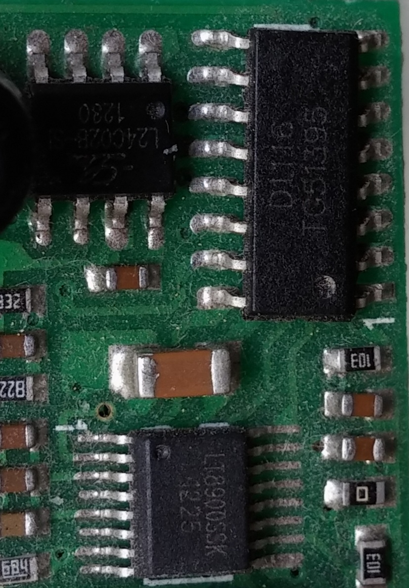

26 Jul 2015 13:57 #36040
Replied by mwm on topic Which protocol uses my Rc Vehicle
This is using the LT8900K transceiver. From what I can tell, it's not compatible with any of the transceiver, so it won't work with deviation.

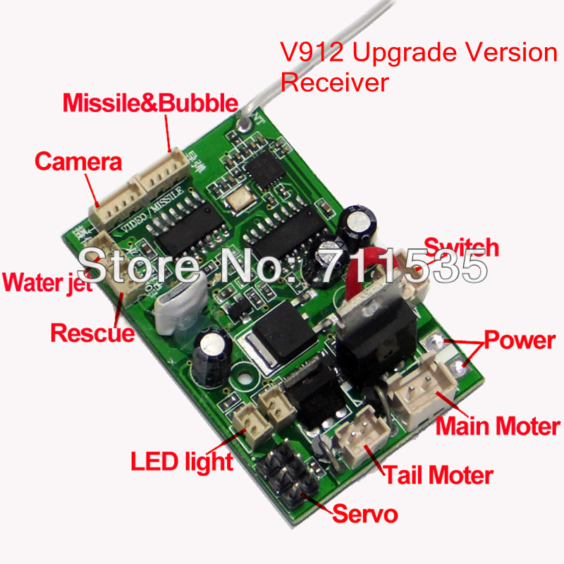

26 Jul 2015 17:58 #36070
by mario
I fly on DeviationTx
Replied by mario on topic Which protocol uses my Rc Vehicle
that's too bad
Thank you for the effort.
there maybe another board which is constructed similar to this , only with nem other rx on it .
Maybe a 4 CH of WLtoys or Mjx seems to fit me ?
Does anyone know if I can control any MJX with the DEVO ??
many Thanks

26 Jul 2015 18:21 - 26 Jul 2015 18:32 #36071
by mario
ok who can read is a clear advantage.
lets go starting. V912 Board looks very good!
