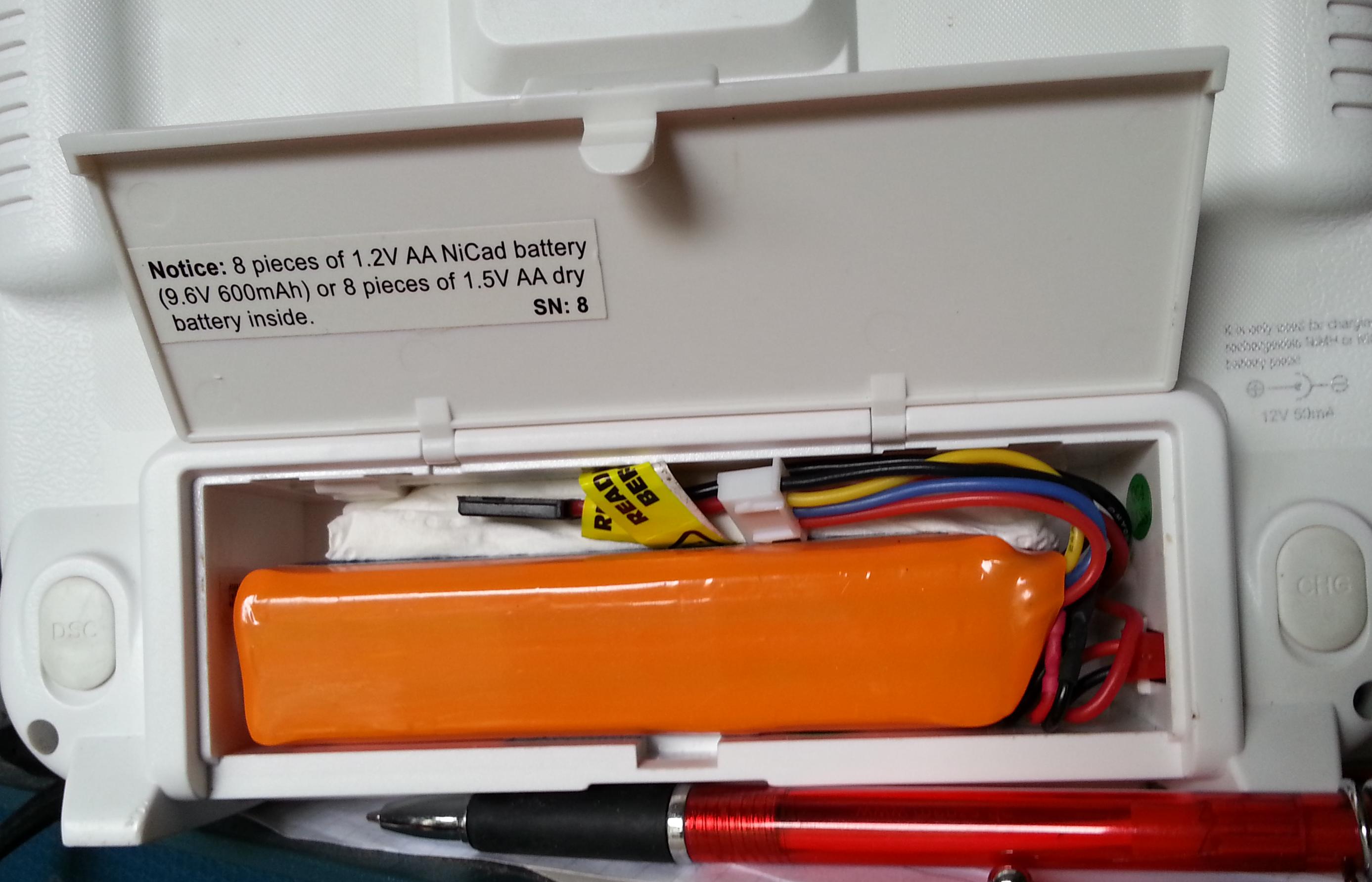

www.hobbyking.com/hobbyking/store/__1795...ansmitter_pack_.html
is also a good choice - has two power cords (one has to be converted to JST, the other can be used to charge without having to remove battery from your transmitter). Is a bit smaller than Devo10 battery case, I have fixed it with folded tissue, and the charging cables can conveniently be stored in the remaining "gap"
Runtime still has to be evaluated, but I guess it's at least 6 hours (it's in there since last week)

Edit: Sorry, did not see the third connector which made the connection to the tx. Then the black Futaba is free for charging.
Replied by aMax on topic Devo 10 Battery suggestions.
Really? Charging through the balancer plug? I have the same pack, but my charger will resist to do that without connecting the JST.ThomasC wrote: ....- has two power cords (one has to be converted to JST, the other can be used to charge without having to remove battery from your transmitter). Is a bit smaller than Devo10 battery case, I have fixed it with folded tissue, and the charging cables can conveniently be stored in the remaining "gap"

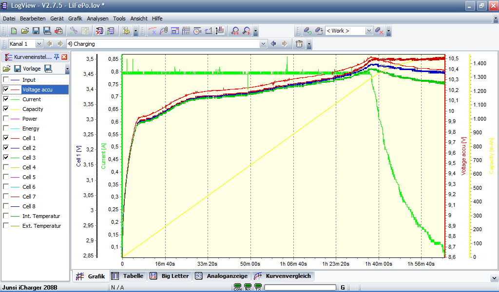

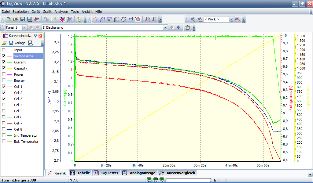

@aMax: yes, the Futaba socket is free for charger connection. I have tested the pack and recommend to adjust charger end voltage to 3,5V per cell. The pack absorbs 1450mAh with that setting. I have bottom balanced the pack (with a resistor and a voltage meter) and won't balance the pack while charging to ensure the cells are at level when they approach empty state to prevent deep discharging of a single cell.

Bottom balancing was a hint I got when I searched the internet and found tips for elecric cars. I did a discharge of my pack (current 1.5A) and found out that cell voltage drops rapidly below 3.0V. After that I decided to use 2.80 volts as balancing target. 2.0V is a bit low, as the pack is nearly empty at 3.0V/cell. I have set my battery warning to 9.2V so there's enough power left to safely land my models.
Attached the discharge log before bottom balancing:
and charge log after bottom balancing:
