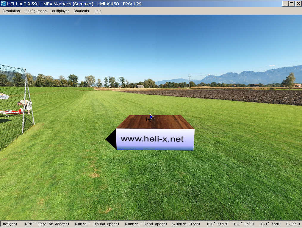

I can see the values change at the bottom of the game screen when I play with the stix,but the heli dont do anythin..........

1. make sure your OS does recognize the controller as gamepad and controls are working
2. calibrate the controller within Heli-X (there's no need to calibrate it in the OS)
3. fly
There's an option to use five channels in Heli-X. Calibration is not straight forward, as you have to create special model settings to calibrate five channels. That way you are able to use all switches (Throttlehold, Dualrate, Flight modes) just like on real models. No need to assign any switches inside Heli-X - just program the simulator model like you would program a real model. But that's another story.
There's a Heli-X support forum at forum.heli-x.info/ in case you have difficulties with Heli-X. DeviationTX works well with all versions of Heli-X. I have tested them all, as I am one of the Heli-X alpha testers.
