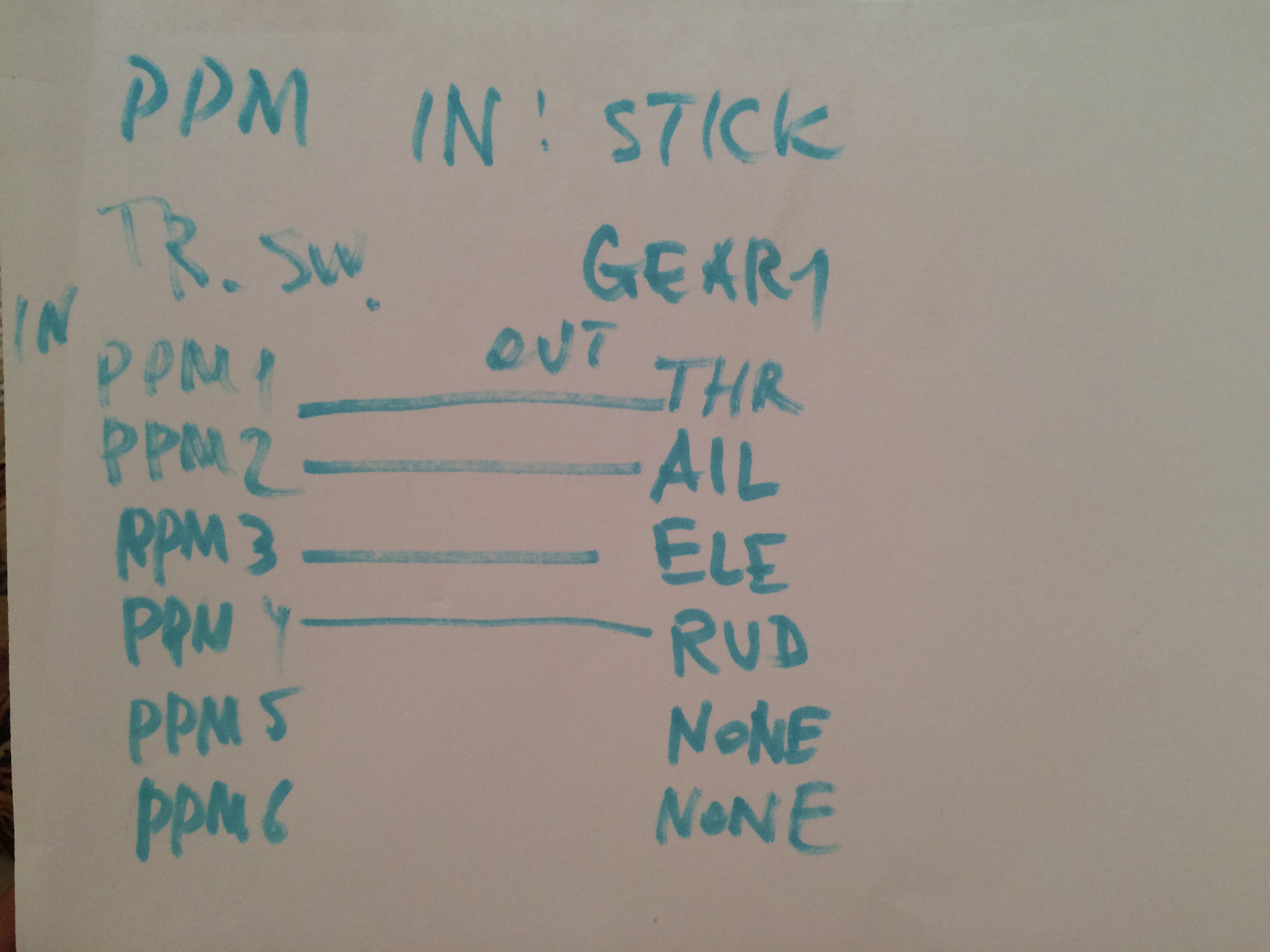

Help set up DEVO 10 and SPEKTRUM DX6 / DX7 in the trainer mode?
I was only so: DEVO - master, SPEKTRUM - slave.
In the picture you can see how I am tormented with catching the channels in PPM-stream.

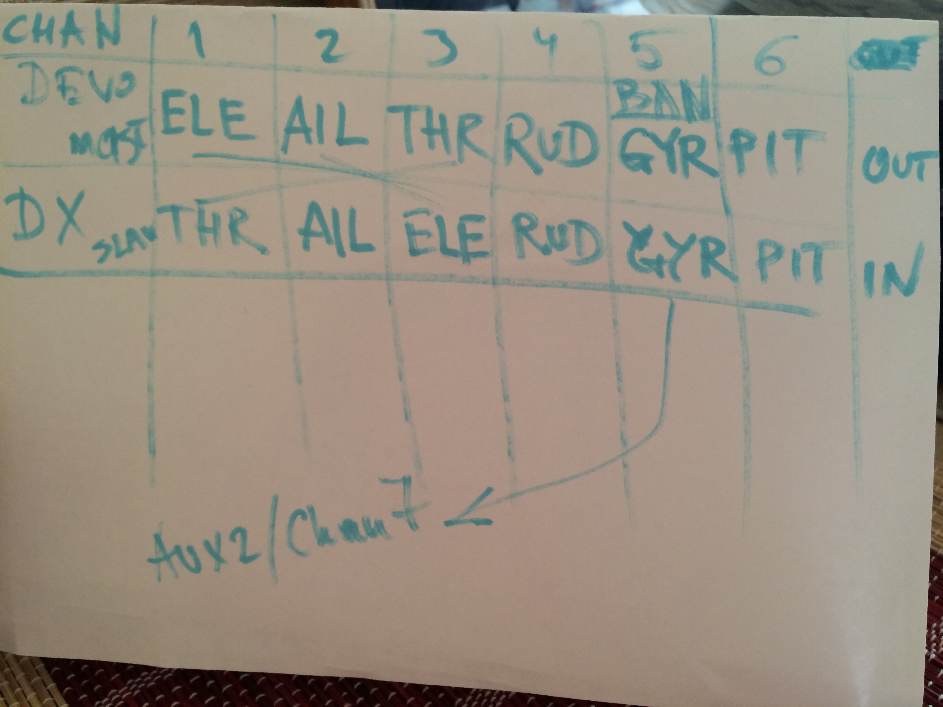

And how do the opposite: SPEKTRUM - master, DEVO - slave?
Can we somehow change the sequence of channels to PPM from DEVO to Spektrum?

There are detailed instructions for setting up deviation for buddy box use in the manuals linked to on the left, section 11.1 of the Devo7e/10 manual. That also tells you how to change the ppm channel mapping to match whatever protocol you are using in master mode. For slave mode, you change the channel order in the mixer, just like you would for any other protocol.
If you want to do wireless trainer, then set the Devo protocol to DSMX to make it a slave, and bind it to the DX6/DX7 as normal (at least, that's how I believe their wireless trainer mode works). If you want the Devo to be a wireless master, you'll need to add an OrangeRx DSMX Rx with CPPM capabilities to your Tx. Cereal_Killer has done some work on using a Sat Rx instead of a full-size one coupled with an Arduino that he's using for extra inputs on a 7E. See deviationtx.com/forum/7-development/4442...-tx-s?start=80#36951 for more info.
