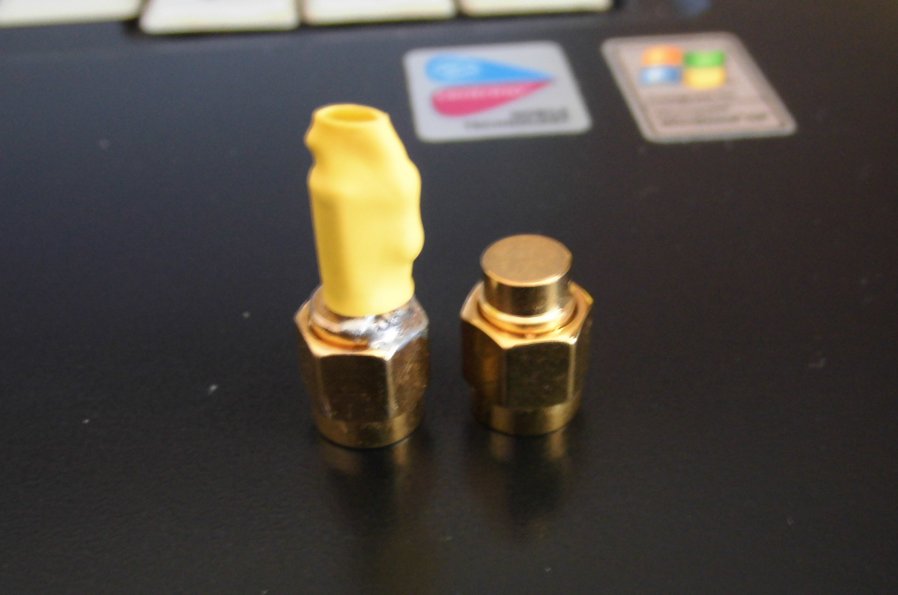

- aMax
- Posts: 776
09 Sep 2015 10:47 - 09 Sep 2015 11:11 #37594
by aMax
Attention, these from BG will not fit your antenna sockets, they are SMA. Seach on ebay some RP-SMA loads.
I build some on my own from connectors that have been left after antenna mods.
These 50 Ohms are standart.
Replied by aMax on topic Antenna plugged-in
Fernando wrote: Hi aMax, sorry but I don't know exaclty what you mean with "dummy load". Where can I purchase it? May be is something like this?
www.banggood.com/SMA-Male-RF-Coaxial-Ter...50-Ohm-p-927353.html
Last edit: 09 Sep 2015 11:11 by aMax. Reason: adding a photo
