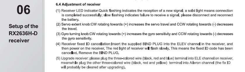

I recently bought for my old V120d02 a Walkera RX2636H-D receiver (a new one).
My transmitter is a Devo 8S with Version 4.0.1of Deviation that works great with my other Walkera helicopters.
I flashed this receiver with Walkera firmware version V1.1 2012-8-6 (with telemetry).
I can not bind this new receiver with my Tx. I tried everything!
By reading various specialized forums I saw that this problem is known but I have not found any solution to resolve it.
At Walkera.com ... almost nothing about helicopters ... they have completely forgotten the past !!
It bored me to put all this new equipment in the trash anyway!
Any ideas?
Thank you

Have you tried bind plug?

Latest firmware version is v2.0 not v1.1, maybe the newer version fixed the problem:
www.hobbyone.com.hk/progoods.php?id=469&type=fly
Remove fixed ID´s from TX and RX before you try to bind.

@Bullfrog: only difference between 1.1 and 2.0 is that 2.0 replaces telemetry support by S-FHSS support. No bugs are fixed in 2.0.
Surprisingly I found out that fixed ID on RX2636H-D automatically is removed when trying to bind to a model memory without fixed ID (tested this with Devo7, original walkera firmware, and RX2636H-D FW 1.1). You might have set a fixed ID in your model memory - please delete fixed ID (set to "none") and retry.

Of course I started by trying to bind with the bind plug. it did not work.
I also tried the 2.0 version for Futaba and saw that there was not the telemetry, same result.
@ThomasC : I'll try this method soon
Thank you very much to all
I will give you news of my tests
