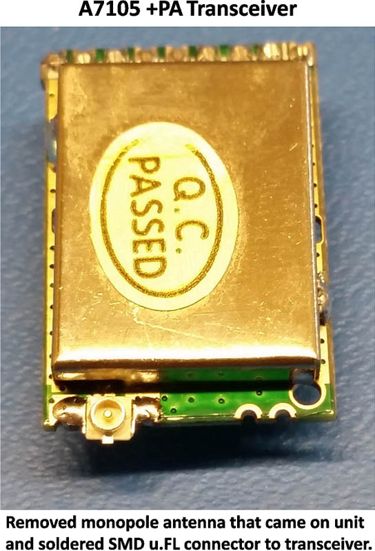

by RedSleds
Replied by RedSleds on topic A7105 module strain relief
Here is what I did
www.amazon.com/gp/product/B00CXOC5Z4
It's available with free shipping if you have an Amazon PRIME membership.
