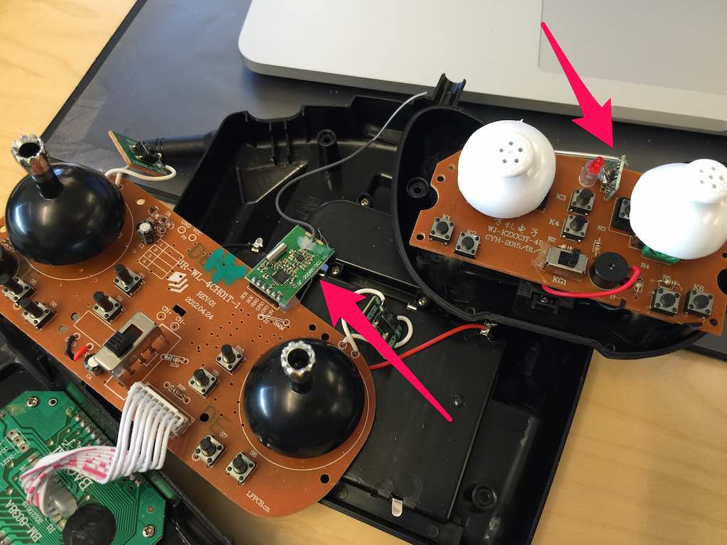

In the attached image you can see the RF-module in the V929 radio to the left and the smaller RF-module in the H8-radio to the right.

It almost certainly won't work.
Both of your theories about cheap RF modules are correct.
Some RF modules just do communications, and you communicate with them via i²C. The code on the µ-controller is specific to that RF module, and you need to update that code when you change the RF module. Otherwise it won't work. FWIW, these are the ones that can be made to work with deviation
Some RF modules have µ-controllers built in/on, and you communicate signals with them via PPM. This handle all the protocol stuff on/in the module, so might work, but I wouldn't bet on it. At the very least they'll have a chip enable line that needs to be held in the "on" state to get them to work. Binding behavior is module-specific, and may require some controller input to trigger as well. Could be anything from "try and connect at power on, and if we don't in X seconds start binding", or a pin that needs to be toggled, or who knows what. These don't work with deviation, so I haven't looked at them. They do work with OpenTx, and you might have better look asking on their forums.

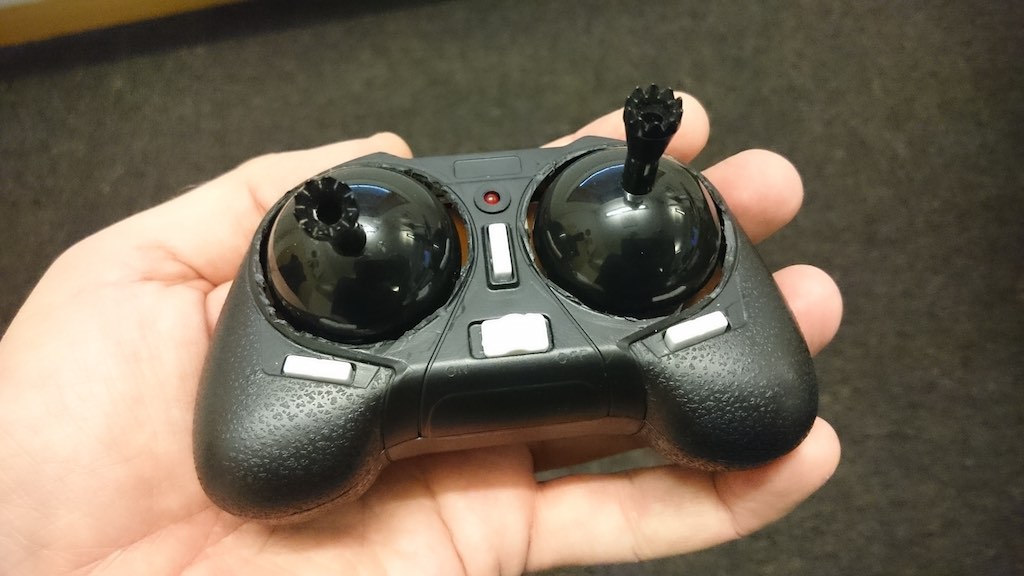

Thank you very much. This is exactly what I needed to know. So instead of trying to swap the modules just to see that it wouldn't work I did a much simpler hack. Making the original remote slightly better anyway. And recommending the Devo 7e and this web site to the people that want to take it further.
