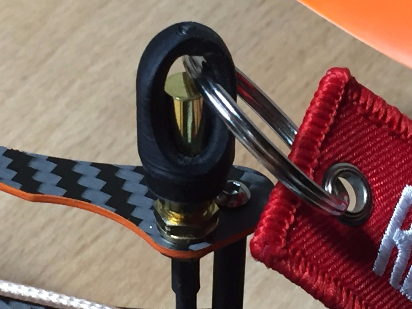

I found this SMA Plug that claims it absorbs up to 600mw of transmitter energy. It's designed to put on your quad's vtx while transporting. I have a modded Devo 6s with a CC2500 module in it and an A7105. Right now, I do not use the CC2500. It has a fragile cloverleaf antenna that I feel like i'm going to damage. Can I use the SMA plug instead to protect the module, and then put the clover leaf on when I need to fly that protocol? I just don't want to burn out the module before I ever get a chance to use it.

The only concern would be if the load is frequency dependent. Usually these are resistive loads and work fine at all reasonable frequencies. But the ebay info doesn't say for sure.

Normally those dummy loads are basically a 50 Ohm resistor, (you can measure with your meter) they should work fine on any frequency below the specified freq.
So if they are good up to 5.8ghz VTX, than foir sure can be used on 2,4Ghz
Higher frequencies could be problem, but I think would not do any damage, but only the SWR might not be full 1:1...
