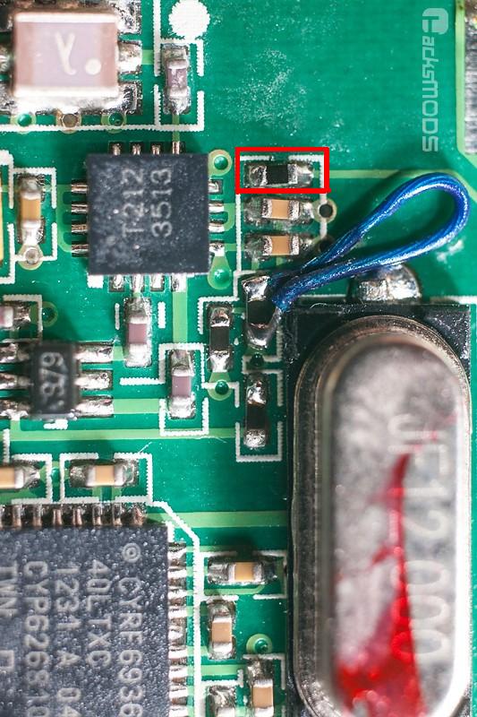

I tried using conductive ink to perform my diode range mod and accidentally spilled a drop onto half a dozen components in the process. It was quite liquid and I managed to wipe it up and scrap off what I could see.
In the end the correct diode has been bridged, but when i edit my tx.ini and perform a range test, I'm only getting 20-25m at full power with an OrangeRX R615X. About the same as before the mod.
With the power disconnected, I have tested continuity with my multimeter, the diode requiring the mod, appears bridged. The other diodes/resistors in the area havent been shorted, as far as I can tell. Except for the one I have marked in the attached image (not my photo, stolen from hacksmods.com). Could this be the cause of my problems? Should it have continuity or not? I'm not very educated when it comes to electronics. Just learning as I go building my first ZMR250 quad.

Leaving the RF Shield shouldn't affect range.
Post your tx.ini file so we can see if it's correct.
