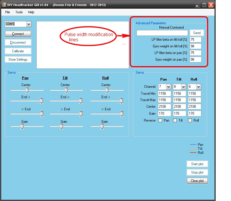

I can't find anything about the delta pulse width in RCgroups.
It is mentioned in the User Documentation included in a ZIP file with the GUI, but I don't know how to play with that values in GUI. (see attachments)
Regards.
Regards.
