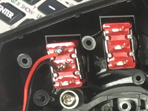

I'm pretty certain the use of one diode installed on the center/common post per switch would be fine. The outer two posts can not come in contact with each other as both can not be in contact with the common post at the same time as you suggested.

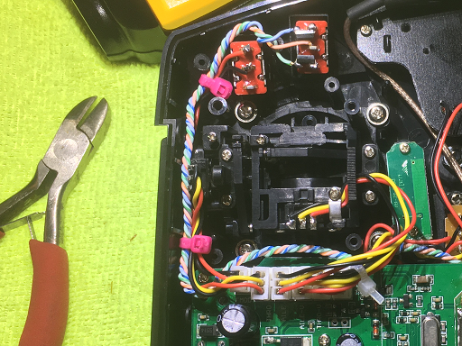

I completed this mod tonight - very simple. However, I did use two diodes per switch.
The diodes I used are intended to be surface mounted, however, they function as expected.

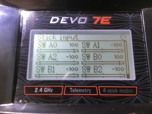

Don't forget to edit the hardware.ini file so software is aware they are present. The "Channel Monitor" feature is a decent way to verify they are working with default values.
