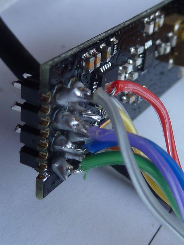

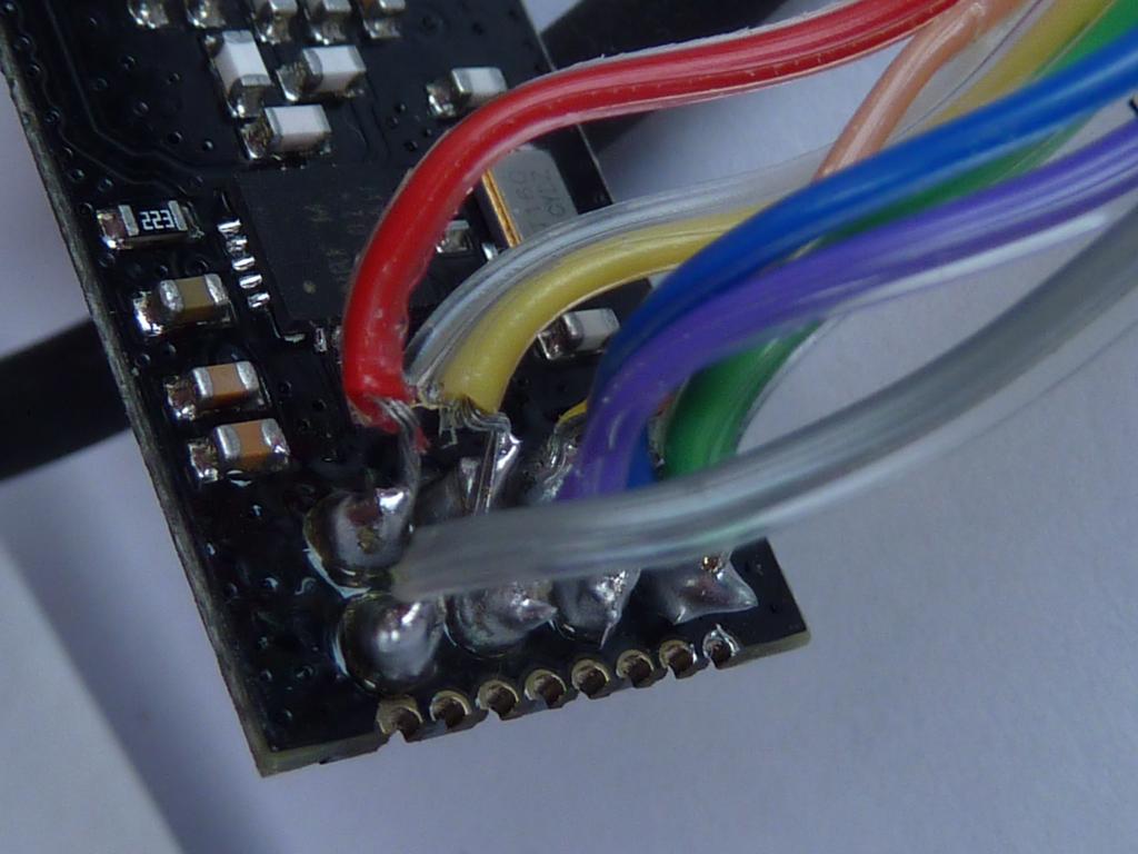

Here's pictures of my soldering and the module.
Last edit: 04 Mar 2016 17:29 by doctortim.

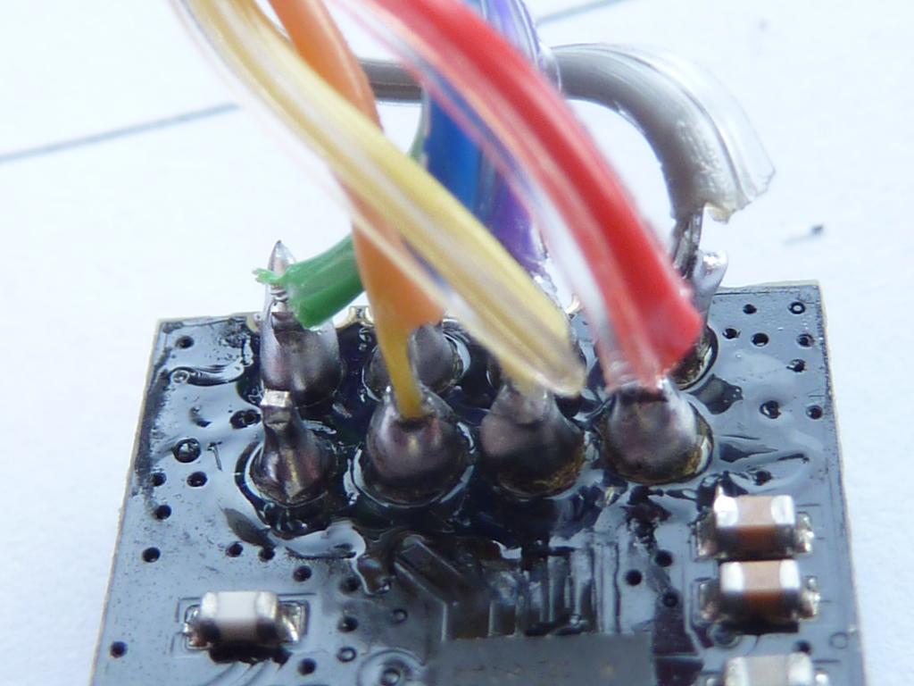

04 Mar 2016 17:30 - 04 Mar 2016 17:41 #44105 by doctortim
Soldering
Last edit: 04 Mar 2016 17:41 by doctortim.

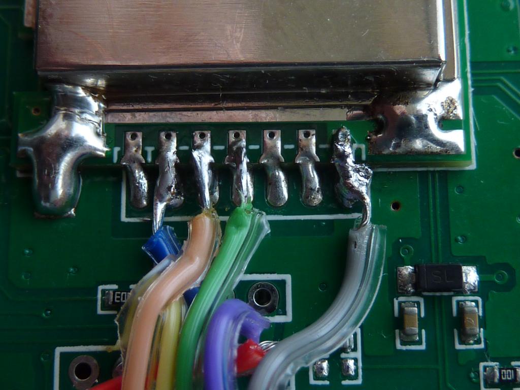

04 Mar 2016 17:42 - 04 Mar 2016 17:44 #44106 by doctortim
Soldering
Last edit: 04 Mar 2016 17:44 by doctortim.

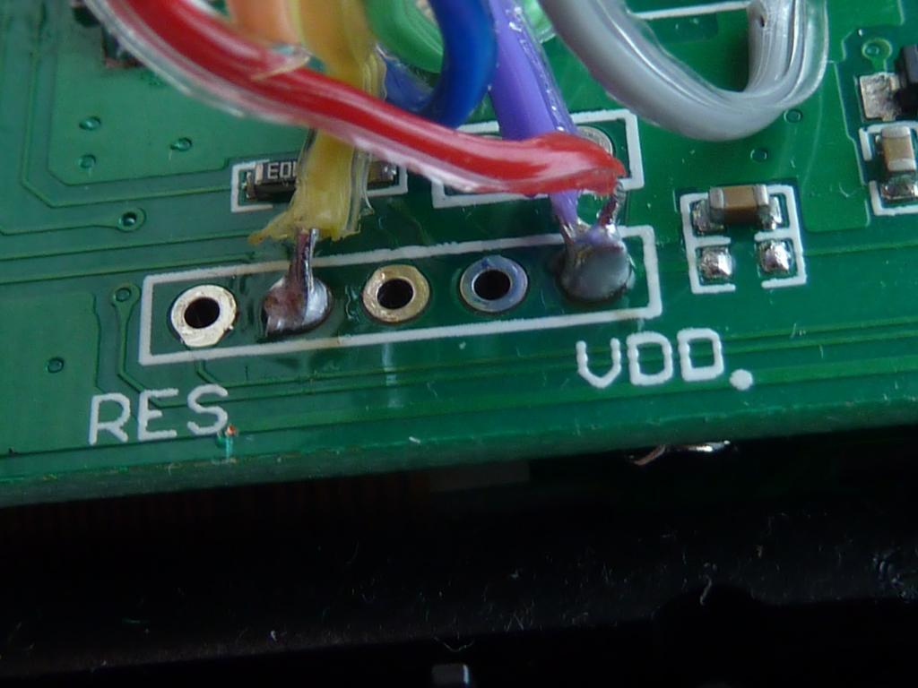

04 Mar 2016 17:47 #44108 by doctortim
Soldering

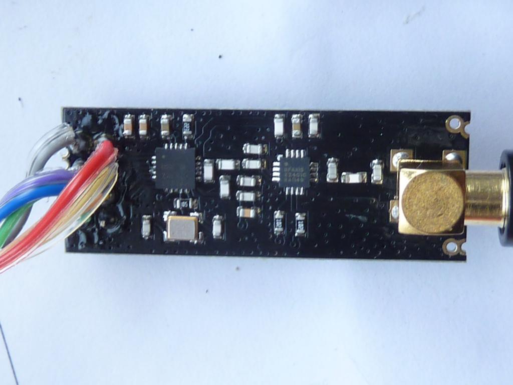

04 Mar 2016 17:49 #44109 by doctortim
Soldering
04 Mar 2016 18:06 - 04 Mar 2016 18:06 #44110 by doctortim
Soldering. The last connection looks a little dodgy but it's good underneath.
Last edit: 04 Mar 2016 18:06 by doctortim.

04 Mar 2016 22:03 #44116 by Deal57
Soldering looks ok, I think. The only thing I noticed is that there might be a hairline wire between the yellow (CSN) and orange (MOSI) wires on the module end. But a short there would probably cause problems whenever you fly, so I may just be misinterpreting the photo. It appears that everything is wired to the correct points.

05 Mar 2016 11:18 #44136 by doctortim
It's not a hairline wire, the board has some sort of lacquer on it, and the line is where the flow is uneven.
The quads are pretty common, I can't see both being so different that nobody else has experienced this.
My feeling is that the nrf24l01 is to blame. Looking at pictures online, it looks quite likely to be fake. Although this doesn't necessarily mean that it doesn't function the same as an original, I've now read a few reports of problems that might be relevant.
