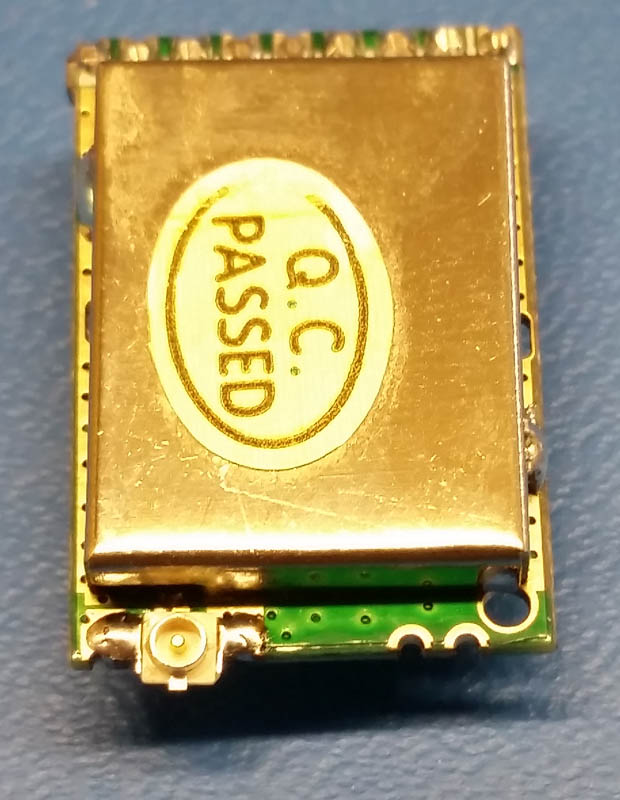

Here's a pic of my soldering job. It is a bit tricky to get it done because it is so small. Liquid flux on the 3 module pads and u.FL connector, tin only the center pad of the module, position the u.FL, apply iron to the protruding tab of the u.FL until it melts the solder of the tinned pad and the u.FL connector is seated down, let it cool for a little while, then solder the two outer pads (the flux that you put on earlier will wick the solder in).
