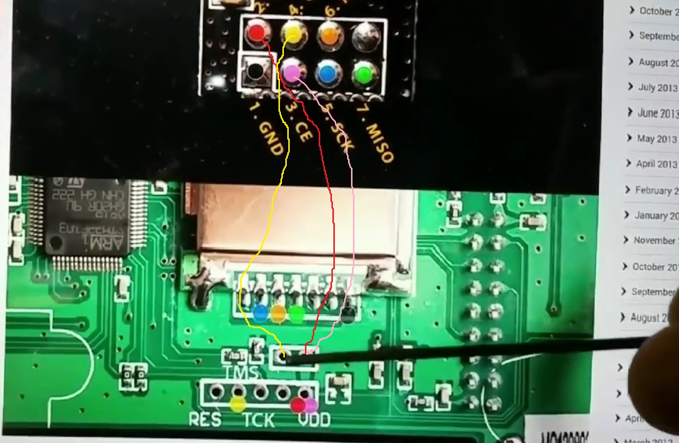

Hi, i am making a 'Devo 7e Mod NFL024 Made easy' video,, i am doing this as i go along as i believe being a newbie to mods and Devo gives me the opportunity to highlight the 'Must Knows' and pitfalls which many people after time (applies to all hobbies/sports/work) simply forget what they didn't understand and hence don't highlight such when learning others.
Anyways i gotta make sure it is 100% right for both my MOD and for the video.
Can i check,, if only ONE module is fitted to a Devo 7e, am i correct in saying the wires should be as pic attached?
Also, in the ini file i leave the 14 as 14, i do NOT change it to 13 as i have not soldered wires to TCK. Is this correct,
But i still remove semi colon in front of 'has NFL24 ' ?

the yellow, red and pink lines go to the wrong connections, the color dots are correct.
TMS = A13 and TCK = A14. It does not matter which one you use. If you connect csn to TMS than it should be A13 and if you use TCK than it should be A14.

It's an nRF24L01, ......not NFL
...and, if the transceiver has power amplifiers (+PA +LNA) you need to un-comment the has_pa-nrf24l01 = 1 line as well
