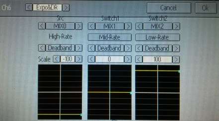

I have just installed deviation 4.0.1 plus the last nightly build. I was able to bind a receiver with no problem but when I program the switch outputs non of my three way switches work they just act like a two position switch. My sticks, sliders and knobs work fine with full control. any suggestions would be greatly appreciated.

I cannot get deadband under mix 1 and mix 2 it says linked? with no option to charge it as there are no arrows beside
(linked) to change the option. It does make a lot of sense though, I understand the principle of it now. Don't say anything to anybody but I almost went back to Devention...I just got my first Devo being the 12s the info on here is great I was able to Download and Upgrade with not a lot of problems. I had heard so many good things about the Deviation I think my first Devo had the stock firmware on it for about 5 Minutes. Would it matter at all if you did not have the latest factory firmware before I started, I was thinking no since I had formatted the drive anyway, but just incase please let me know

you have to push on the "Mid-Rate" and the "Low-Rate" button, then "Linked" will gone and you can choose "Deathband", "3-Point", "Expo xx".....

rdeviation wrote: I cannot get deadband under mix 1 and mix 2 it says linked? with no option to charge it as there are no arrows beside
