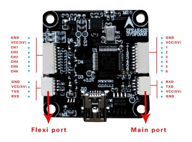

01 Apr 2016 12:47 - 01 Apr 2016 12:57 #45561
by ursus69
Replied by ursus69 on topic ER250 receiver recommendation
Last edit: 01 Apr 2016 12:57 by ursus69.
