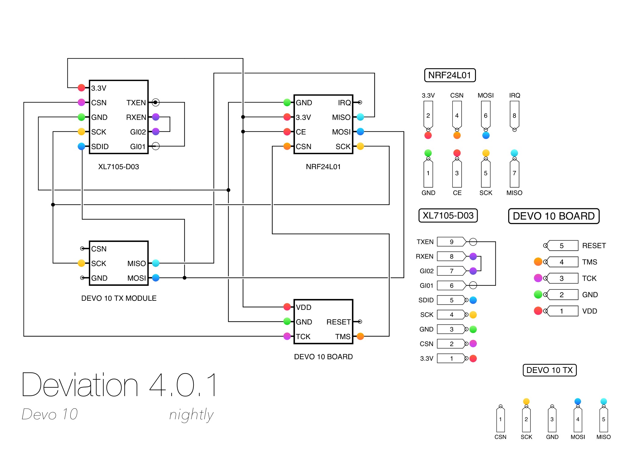

I'm only installing the a7105 module in my devo 10. My question is do I need to connect anything to TMS or MISO?
The diagram below shows theses connections only for another chip. Right now I did not connect them and I am getting the missing module message.
I will take it apart and check all connections. Any input will be appreciated.

- TomPeer
- Posts: 303
30 Apr 2016 18:51 #47502
by TomPeer
Replied by TomPeer on topic Devo 10 A7105 install
If you connected the csn to TCK then you do not need those 2 connections.

- champstar2828
- Posts: 27
30 Apr 2016 18:52 #47503
by champstar2828
Replied by champstar2828 on topic Devo 10 A7105 install
It does, I took the semi colons off of the 2 lines.
- TomPeer
- Posts: 303
30 Apr 2016 18:53 #47504
by TomPeer
did you change A13 to A14
- champstar2828
- Posts: 27
30 Apr 2016 18:59 #47505
by champstar2828
No I did not do that. Is that done in the hardware file?

- champstar2828
- Posts: 27
30 Apr 2016 20:01 #47510
by champstar2828
I re-connected everything and made the change. Now I'm getting missing module cyrf6936.
