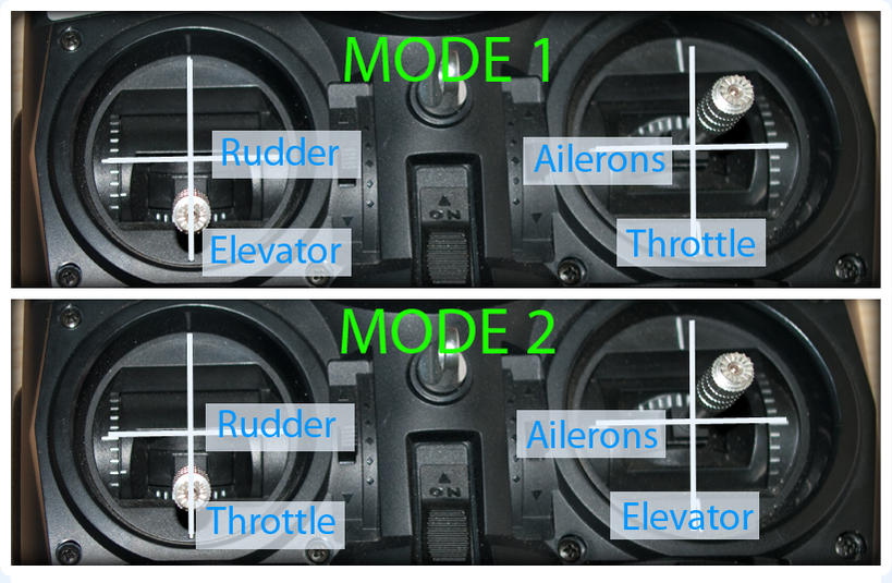

Hi, I am new to this forum and want to ask some questions. I got a Devo 7E with A7105 and NRF24L01 installed. I am using Mode2. I want to ask how to set Channel 1 to THR in setting. eg. In the manual
www.deviationtx.com/user-manual/user-manual-7e-10
www.deviationtx.com/manuals/html-devo10/_images/mixer_main.png
or just load a "Simple 4 Channel" in the template. In the picture the setting is 1-ELE, how to change it to "1-THR" and so on.
Original -> Goal
1-ELE ->1-THR
2-AIL ->2-AIL?
3-THR ->3-ELE?
4-RUD ->4-RUD
So I can give power to the main motor of the plane when pushing left stick upward(north).

The answer is in your picture. Lol... hold R+ to reorder.
Jokes aside. Once in that menu use R+ ans L- to select the channel you want to move. Use UP+ and DN- to highlight the up/down buttons. Then ENT to move in the direction you've selected.
Warning: the mixer screen you showed does not affect the mode of the transmitter. If you are in mode 2 left stick vertical direction is throttle. The mixer screen you showed only affect the channel number that the throttle signal is sent on. I.e the channel that the receiver see the throttle signal. This should be matched to your receiver not based on hiw you expect sticks to react.

Yes everything can be programmed on the 7e without using a pc.
What you see in mixer on the left is channel sending order with labels based on how the receiver expects to see it. Often the receiver labels will name their channels. As such this is just a naming convention and will change with different protocols.
The right side allows you to override the source signal that is sent to the channel number but does not change the name.
The problem you are seeing is because you haven't choosen the correct protocol for the model you are flying. You need to set this up in the model page first and select HM830. After that you will see the labels in the order you expect.
You can then use the mixer page to adjust to simple and select the appropriate curves and sources as you see in the ini file.
The sequence rules for TAER, EATR, AETR, etc depends on your protocol based on the receiver you use. Just remember, they are just labels which sugest the sources you need to link, but you are free to send some other source. I.e, the ini file you are looking at is sending a throttle source on both channel 1 and 3 even though 3 is elevator.

A few words of warning on the labels. Slipstream is quite correct that they are just labels based on how the protocol's receivers expect those channels to be used. But they also get used by deviation in setting up the "default" template. It'll do what the protocol expects as most likely to be right. But 2-channel and 3-channel aircraft tend to do things slightly differently, connecting the RUD channel to the AIL since the RUD is missing. Also, companies that do per-model transmitters tend to tweak the protocols for whatever is easiest for them for every model (or revision of a model!), so while the labels match the model that the protocol was developed from, it may not match other models that work with that protocol.
