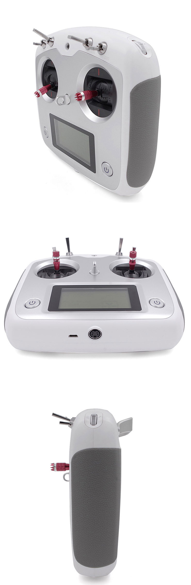

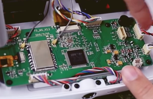

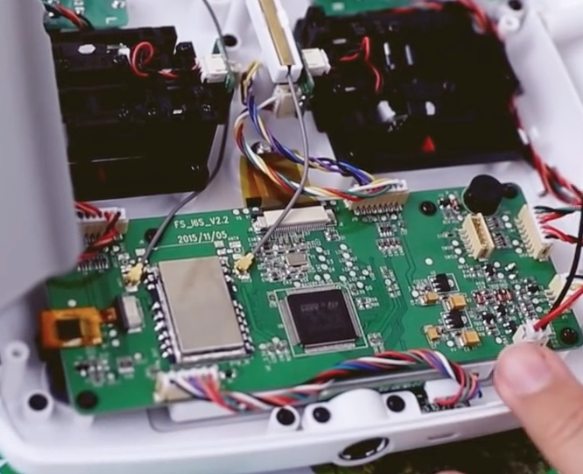

13 May 2016 08:34 - 13 May 2016 09:31 #48332 by silpstream
Replied by silpstream on topic Replacement for the DEVO series for the future
I was searching around and stumbled on this sweet looking tx from flysky. The FS-i6S for $65 on BG ( www.banggood.com/Flysky-FS-i6S-2_4G-6CH-...zO1swCFQyZvAodztEMuw ).
Couldn't find much information about its' internals, but watching a video of removing the spring did provide some hints. It seems to have a 100 pin ST ARM processor, and the way the RF module is soldered in, might suggest a SPI interface. There also seem to be a lot of test pads broken out, so soldering to them may be easier if those points are usable. It has USB and is supposed to be upgradable, so possibly stock bootloader if it is one of the usb, not uart, bootloader enabled chips from ST??? With the top 2 rotatable (not rotary) switches and the 2 power buttons, we would have 6 switches for the menu similar to our demo transmitters. Lastly it has a nice complement of switches (two 2-way, 2-3way, 2 rotatable on the shoulders, and 2 momentary buttons on the rear) and looks really clean, with a B/W touch screen interface.
For the price and if the processor is any good. We might have a winner. I'd take this over the radiolink any day if it ran deviation.
Last edit: 13 May 2016 09:31 by silpstream.

I do like that flysky i6S as a potential 7e replacement. It doesn't look like an STMF103, but it is probably ARM. The RF connector seems to have more pins than I'd expect it to as well. And there doesn't appear to be any on-board serial flash. So who knows what we can do with this thing. But at $65, it is worth it just to see what we get. I ordered one.
13 May 2016 13:47 #48349 by silpstream
PhracturedBlue wrote: I do like that flysky i6S as a potential 7e replacement. It doesn't look like an STMF103, but it is probably ARM. The RF connector seems to have more pins than I'd expect it to as well. And there doesn't appear to be any on-board serial flash. So who knows what we can do with this thing. But at $65, it is worth it just to see what we get. I ordered one.
I felt it looked like the STM103Vxxx series.
The 9x was a stab in the dark. :lol:
I wished I had your purchasing power... :dry: and can't wait to hear your findings. :woohoo:
13 May 2016 16:14 #48354 by SeByDocKy
Replied by SeByDocKy on topic Replacement for the DEVO series for the future
FlySky i6S
File Attachment:
128Ko chip :(
