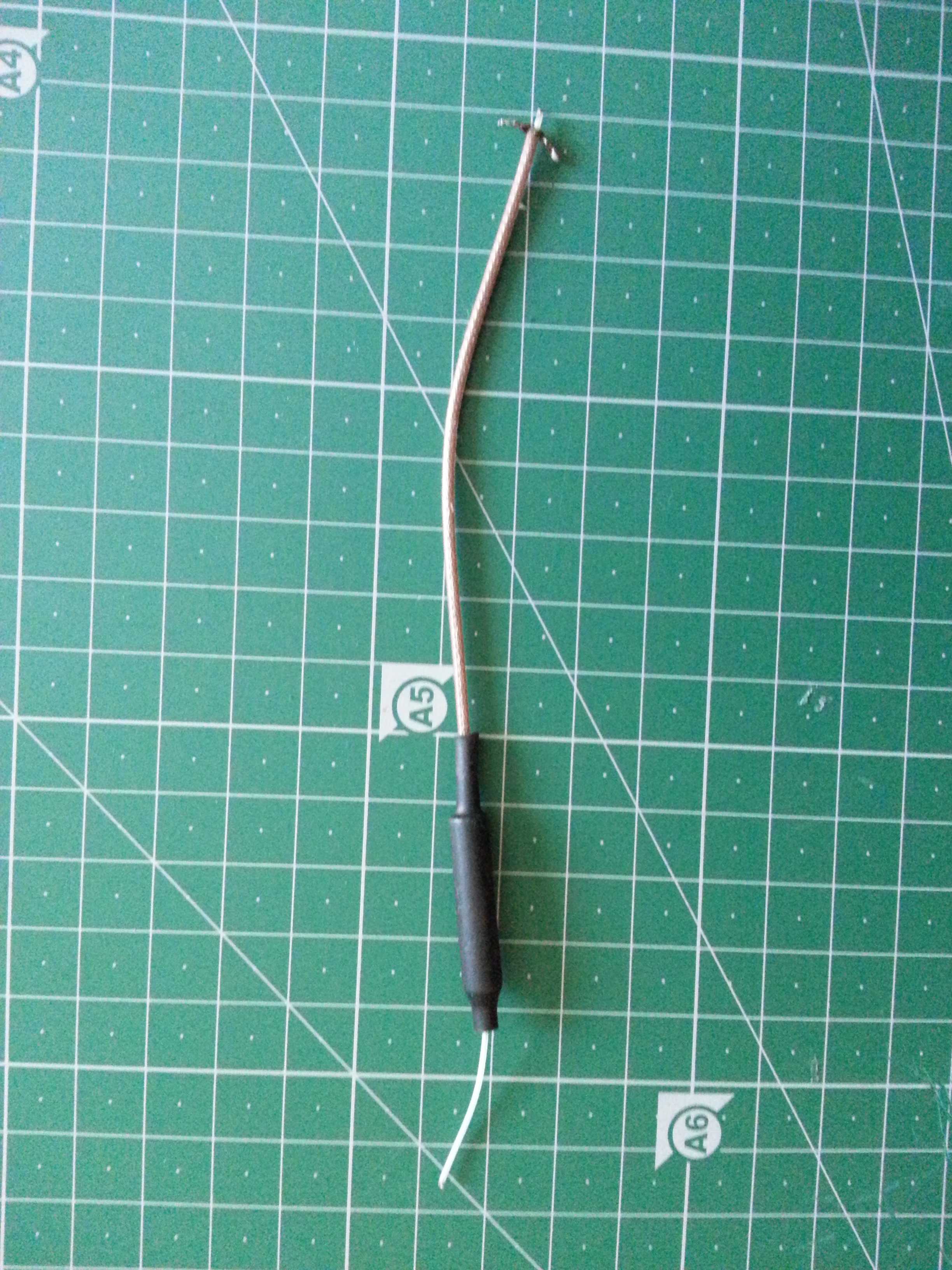

I am even more confused now. Previously my 7e was range moded with conductive ink. With the old module I was using this antenna (see Photo) It was successful with the small drones. But when I started flying model aeroplane with this TX, I was constantly losing contact with the model, within range the motor would cut and no control over the model and then after few seconds contact back and normal. It was not happening once but during the whole duration of flight. Mind you on the ground range test was excellent. I thought might be the conductive ink was not applied properly or it was wearing out. That is why I change the module.
So the conclusion is that I should use this
Antenna 433MHz RP-SMA 2dBi for 3DR Radios @ www.banggood.com/Antenna-433MHz-RP-SMA-2...Radios-p-918634.html
in combination with
Universal 2.4G Receiver Antenna Compatible Futaba JR WFLY @ www.banggood.com/Universal-2_4G-Receiver...-WFLY-p-1005363.html
As now I am totaly confused and I need solid advice,
Thanks again.
