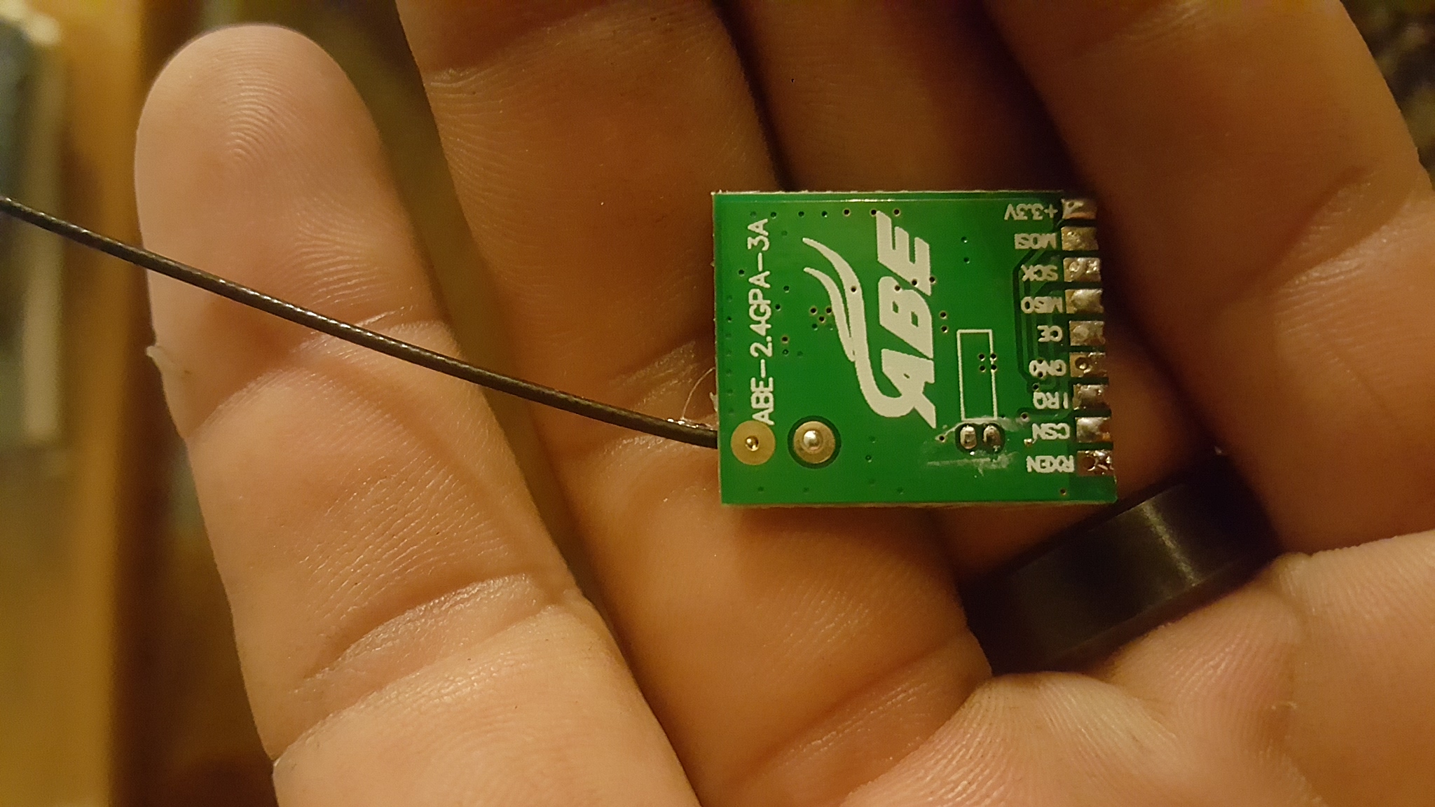

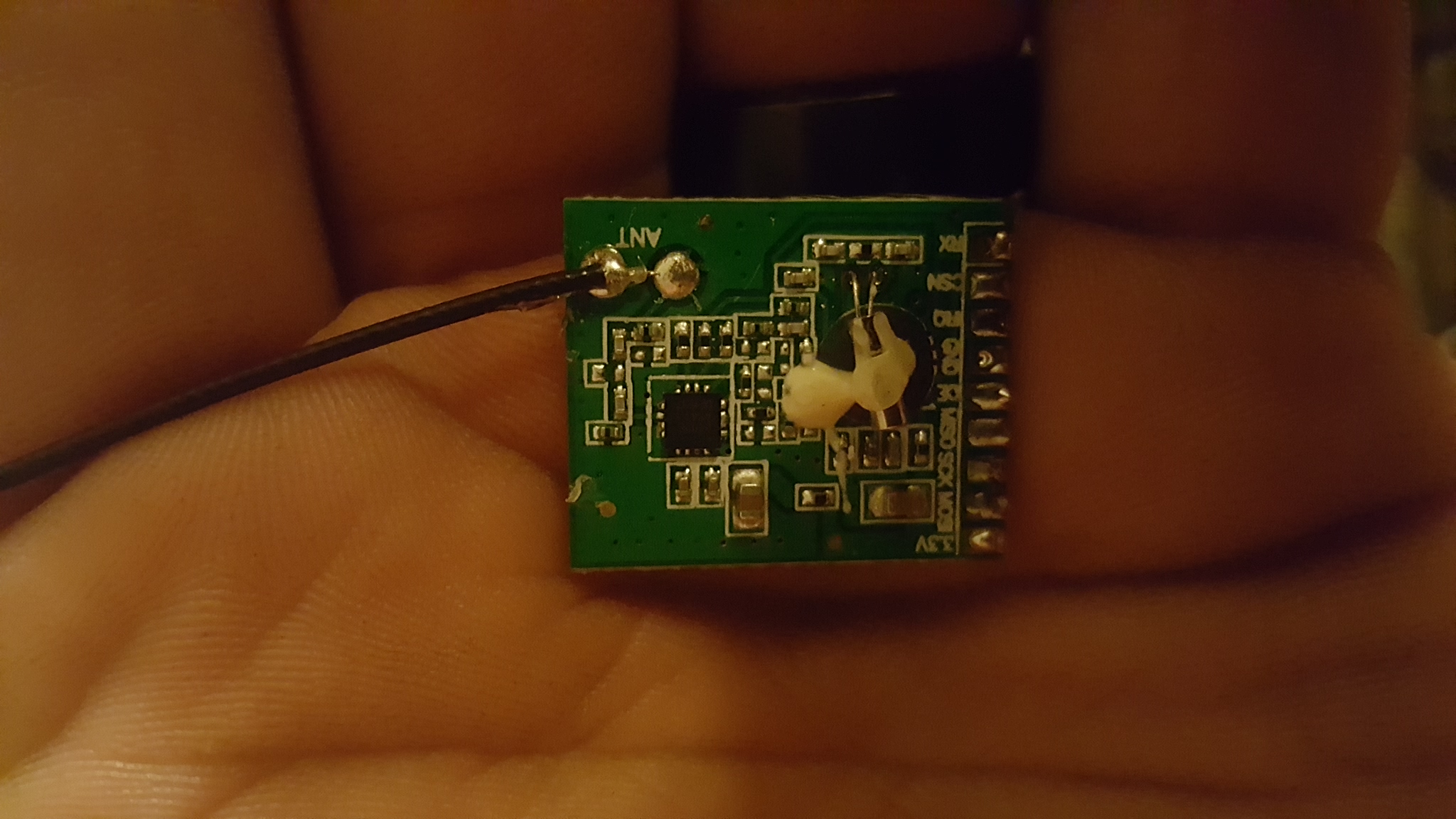

Well I was trying to see if the tx board in my udi tx was one I could use in my devo and I guess I wasent careful enough cuz I snapped the solder pads right off the main board but the tx module is in perfect condition, does anyone know if a ABE-2.4GPA-3A marked chip is any use to me in my devo 10
- HappyHarry
- Posts: 1136
22 Sep 2016 16:31 #54128
by HappyHarry
Replied by HappyHarry on topic TX chip from broken tx
it depends from which udi model the tx is from, I know some use the beken rf chip though
22 Sep 2016 21:02 #54134
Replied by Deal57 on topic TX chip from broken tx
It sure looks like it's in the NRF24L01 family (but which one?) and it looks to me like it has a power amp. The connections are labeled the same as the deviation-supported transmitter modules. If you're up to it, you can wire it up and see if any of the protocols work.

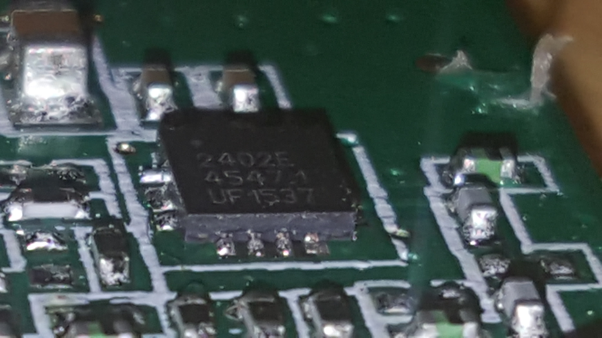

- Cereal_Killer
23 Sep 2016 13:05 #54167
by Cereal_Killer
Replied by Cereal_Killer on topic TX chip from broken tx
Can you read the writing on the black square QFN chip for us? The "ABE-2.4GPA-3A" silk screen print in is the name of the module (and means nothing except to ID that module to the maker), not the chip it's self that we need...

23 Sep 2016 23:54 #54190
by Josegonzalez1985
Replied by Josegonzalez1985 on topic TX chip from broken tx
I think this is what you were talking about cereal
2402e
4547.1
Uf1537
2402e
4547.1
Uf1537
24 Sep 2016 13:52 #54213
That chip is a power amp, and it is often used with the NRF24L01 chip. But with the number of similar and fake clone modules there isn't any way to tell if this is really any particular one, and most don't exactly perform the same. So it may work just fine, or the distance may be limited, or you may see dropouts.

24 Sep 2016 17:02 #54220
by HappyHarry
the udi u818a uses a beken 2421 rf chip, it's mostly nrf24 compatible but I don't think it's 100%
