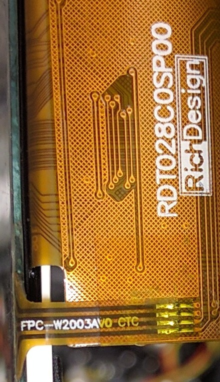

The screen is a re-purposed resistive touch mobile phone screen I think, based on a set of buttons on one edge that are only visible when it is taken out of the transmitter. It has a home and back button, and two others. There is no screen there, just touch sensors.
Also there is a crack under those buttons. It isn't visible when the TX is all put together, but when taken apart it is visible. I'm wondering if this is the issue. I've been looking for replacement touch screens for it, but no luck so far.

06 Oct 2016 05:43 - 06 Oct 2016 05:47 #54646
Replied by vlad_vy on topic Devo 6s Touch Screen Calibration Help
What is the part number? RDT028C0SP00 or something else?

10 Oct 2016 02:19 - 10 Oct 2016 02:20 #54780
by Elmtree
Replied by Elmtree on topic Devo 6s Touch Screen Calibration Help
You were right! That's the screen. I'll try to order it.
I think it'd be a good idea to replace the touch screen too. I took a picture of the board which I've attached here. The part number is FPC-W2003AV0 CTC.
Where do you think I could find that? Same place?
