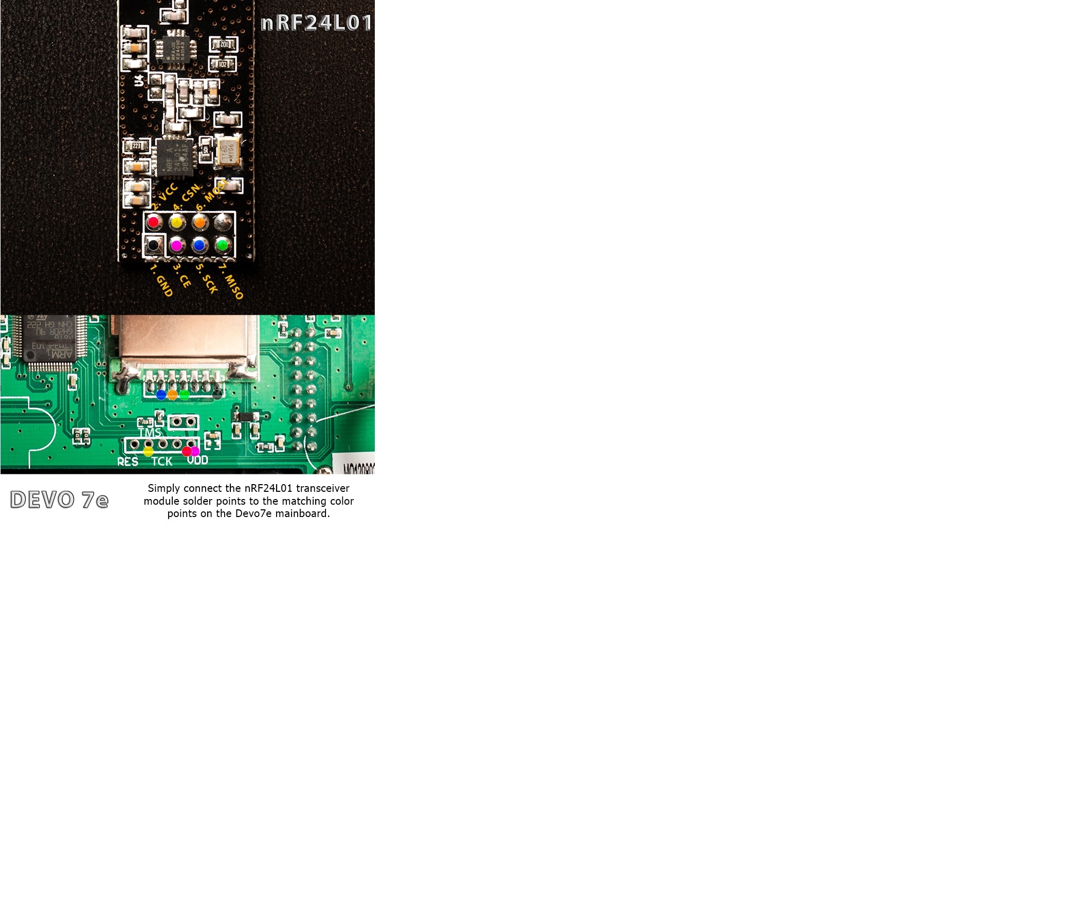

Guys,
I am shortly going to install this module.
I note instructions which state that module pin 3 needs to be connected to module pin 2,
Other instructions do not mention this and just give the corresponding Devo 7e connection points for each of the module pins.
I am therefore confused as to whether I should be connecting these pins on the module.
Can someone clarify please?
Cheers,
Steve

Should work this way
You have to enable the modul with a high level on pin3 (chip enable) so you can shorten it with pin2 (VCC).
You can do this directly on the module so you can reduce wires from 7 to 6 or you connect the red and purple wire on the solderingpoint VDD on the DEVO 7e motherboard.
hope you see clear now.
I did it this way in my DEVO 7e and everything is fine.
