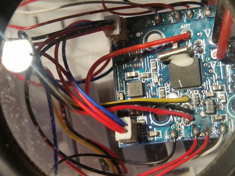

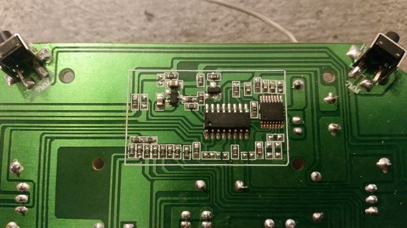

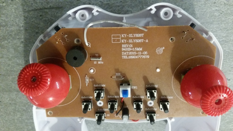

Does anyone know witch protocol this uses? i made some pictures of the transmitter and receiver.

The transceiver chip has 16 pins so it could be a XN297L. Try CX10 protocol.

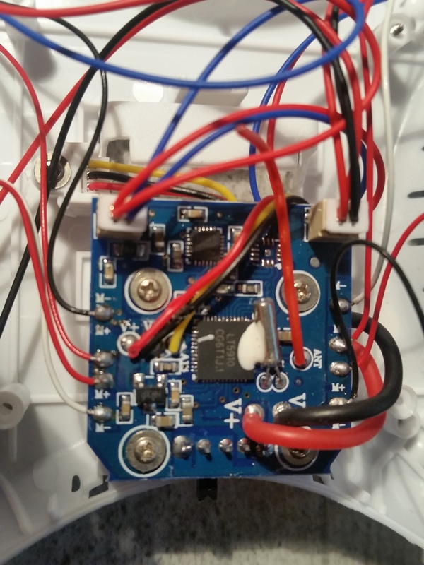

I opend up the drone, its a LT5910...

the LT5910 is just an mcu with an nrf/xn297 compatable rf chip built it, these can be paired with either an nrf or an xn297 in the transmitter. for instance the eachine e010 uses a setup similar to that, a combined mcu/rf chip on the quad and an xn297lbw on the transmitter
