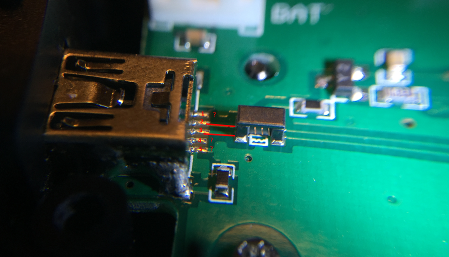

Hello everybody. Here I have accidentally broken the usb connector of my radio. Having good competence in electronics I wanted to launch me in the replacement of the usb port on the card but I have barely broken the track or welds the connector ... I try then for the last attempt to know where I can resume 5 port information on the main map. Can anyone help me? Thank you !

follow tbe trace it's easy to follow from the usb port right back to the mcu, there's lots of space to clesr the solder mask and bridge to the connector with wire

On vois seulement les pistes pour 2 et 3. Le reste j'ignore ou récupérer l'information sur la carte...
