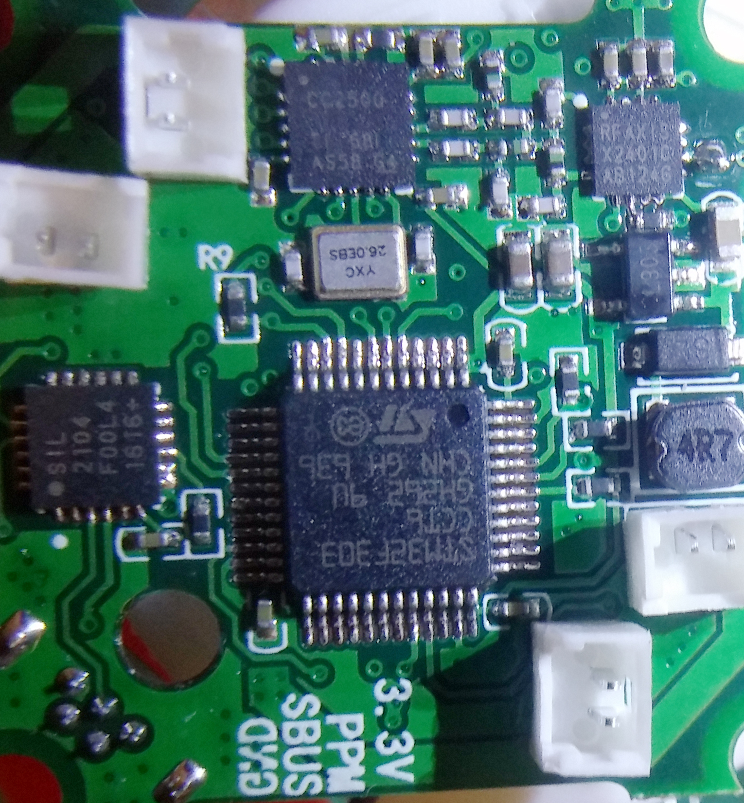

Picture of board attached showing the CC2500 chip, etc...

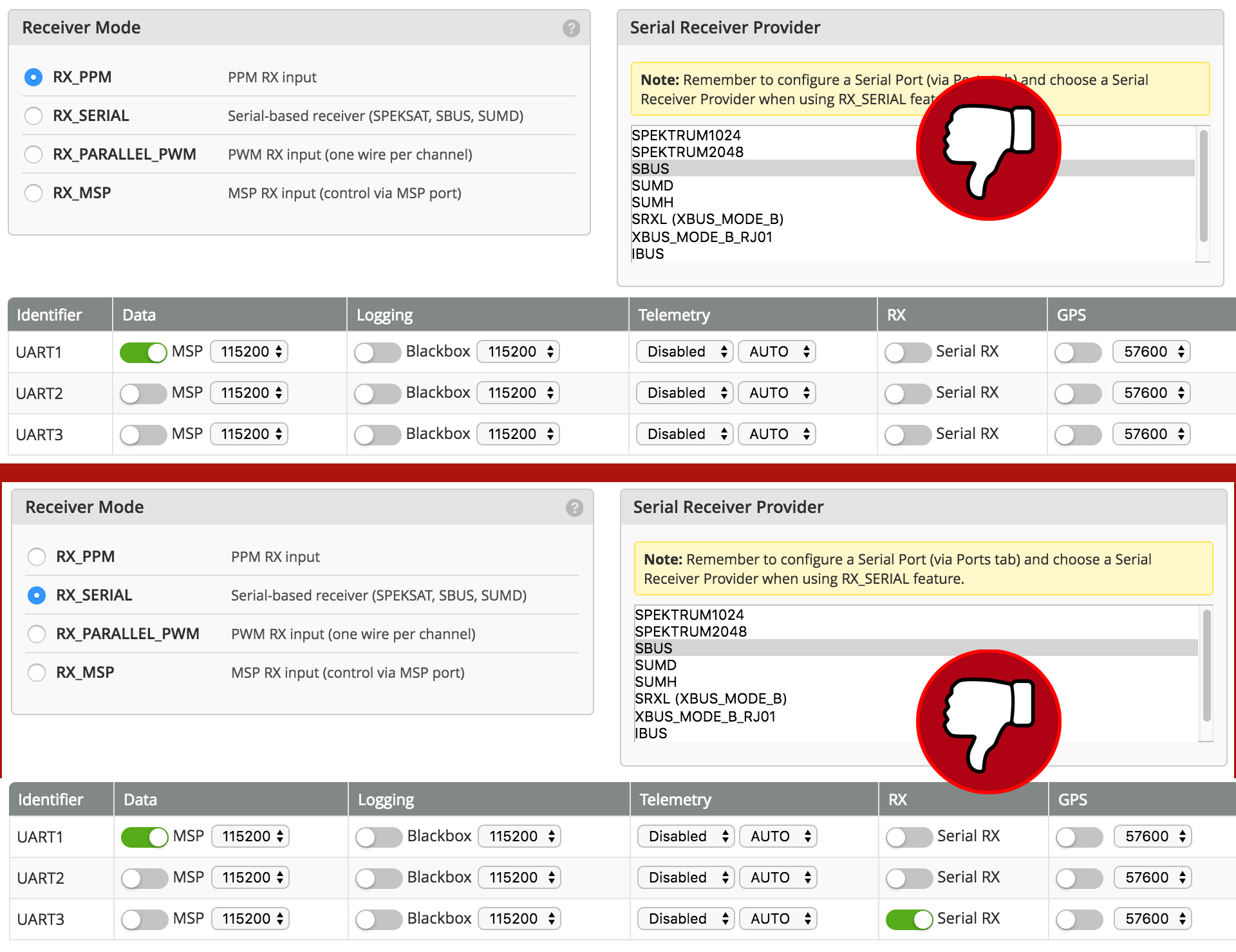

Things I'm Doing:
I know there are a lot of variables, but ... I can't bind to this board which is billed as being "FrSky"

I'm using FrSky as the protocol - is there anything special I would need to do to bind with this board if it is indeed setup for only PPM using the FrSky protocol? Is there any chance the other settings might mess this up? Like FixedID or anything like that?

- In clean flight, I've tried to when using Serial selecting various UARTs as serial with no joy.
- In clean flight, when trying PPM - turn off the UARTs except the "Data" one.
