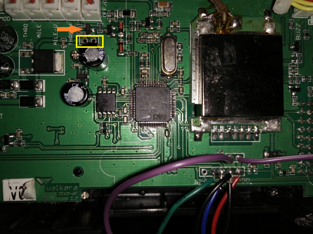

it could be that the pfet used to turn the power on/off has failed, another possibility is that the 3.3v vreg has failed. what were you powering the 7e with? also do you have extra modules fitted? if so which? a test to check both components at once would be to place a jumper over the pins under the pfet, if the tx powers up when the jumper is connected then the vreg is fine and there is an issue with the switch/pfet, if it doesn't it will require further testing. i've highlighted the pfet and the pins you need to jumper to test this in the attached picture

I'm a Girl not that it should matter but i don't know to much about the electronics of it all , But I can fly good lol I did open it up and see what u have marked in ur pic

The Orange arrow in Happy Harry's photo is a part which is the actual "switch" (the power switch in the front that you manipulate is only the user input, it doesn't actually physically disconnect power)...
Use a pair of metal tweezers and touch one prong of each to the two vias (metal plated holes) that he's highlighted in yellow box and see if it powers up. If it does this indicates to us what the problem is and we can help you with what to do next, if it doesn't power up it tells us something more is wrong and we'll dig in if we need to. Good luck. DO NOT TOUCH ANYTHING ELSE ACCIDENTALLY WITH SAID TWEEZERS! You need to have a very steady hand while you're poking around in there as touching the wrong pads will create a dead short between + and - (and bad things happen when you do that)

if you don't have tweezers you could also use a pulled open metal paper clip, or a length of wire with bared ends etc anything to make an electrical contact between the two points. also your right being a girl doesn't matter one bit
