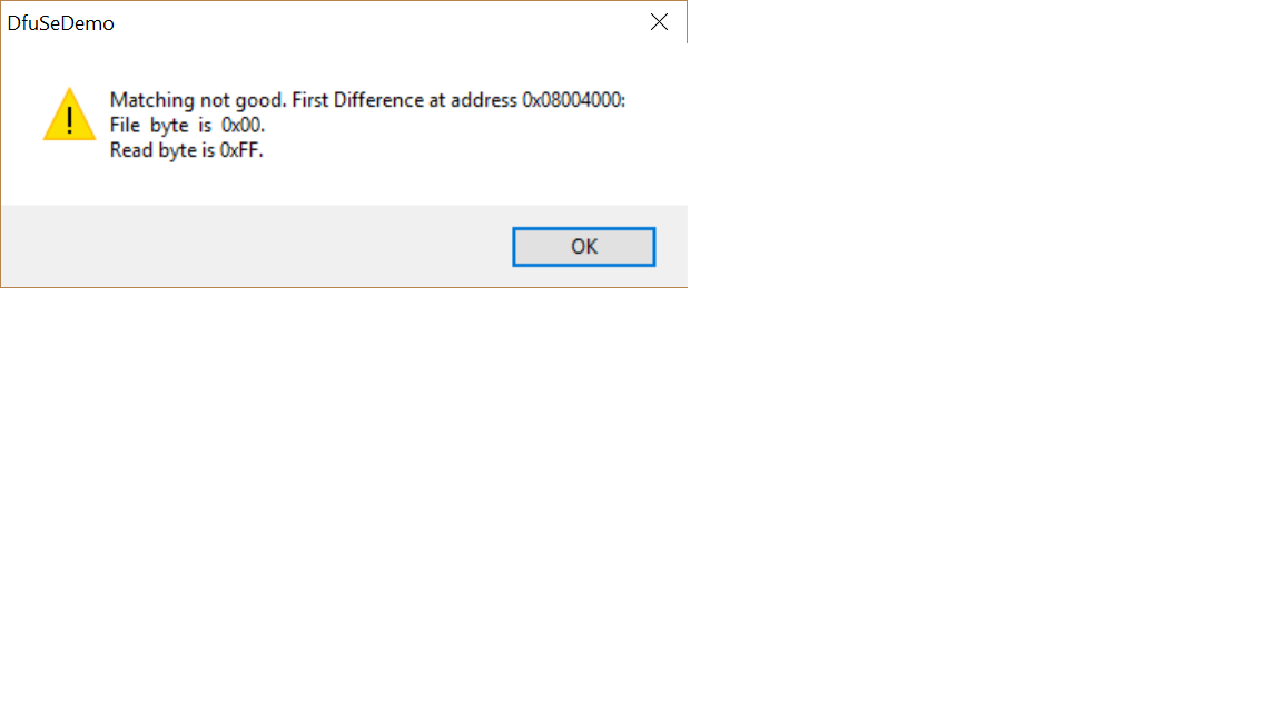

brand new devo 10, tried to install deviation and everything looks good, except I'm restarting the Tx and it always looks like I've held down Ext...
I've tried holding down ent, and I've tried not holding down ent and it makes no difference.
Windows 10
DfuSe Demo v3.0.5
please tell me I haven't just bricked this brand new Tx...
Windows 10
DfuSe Demo v3.0.5

- gnelson0265
16 Jan 2017 00:59 #58016
by gnelson0265
Replied by gnelson0265 on topic Devo 10: Can't get out of program mode
Fixed!
Lesson to be learned, don't use DfuSe v3.0.5
I went back to V2 and it worked first time
