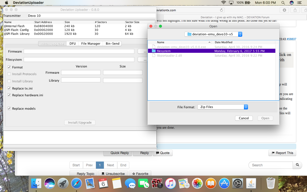

This is what I end up with, even though I'm clicking on the file that I want to install it just keeps opening more and more files and no of them are high lighted as you go and you can see that the (open) tab is not high lighted nor is it ever in this process..

Dumbtrucker wrote: This is what I end up with, even though I'm clicking on the file that I want to install it just keeps opening more and more files and no of them are high lighted as you go and you can see that the (open) tab is not high lighted nor is it ever in this process..
The screen shot shows a couple of problems you can fix.
- First, you downloaded the wrong file for the firmware. What you have is an emulator file for Deviation - a file that is meant to run on Windows computers that emulate the behavior of Deviation on a Devo 10. Make absolutely sure you download the correct version for your Devo 10 that does not have "emu" in the name.
- Second, you unzipped the file that you downloaded, thus resulting in that bunch of files. Do not unzip the file that you download.
... You can do this ... !

I don't know why you're getting a white screen on the Devo. Since you are unable to continue with installing Deviation, you could try removing the Devo's battery for, say 15 to 30 minutes and see if that will get you back to working condition.
As for unzipping the file, it shows in the prior screenshot that it has obviously been unzipped. This could be happening automatically if you have a setting in your Safari's Preferences for that.
In Safari's Preferences, under General, at the bottom of the window, there is a checkbox for "Open "Safe" Files after Downloading". If that box is checked, it will cause downloaded .zip files to be unzipped immediately after the download completes.
