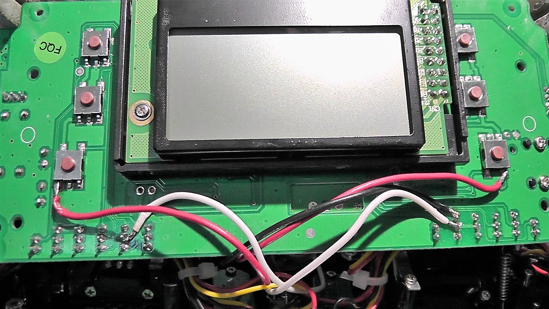

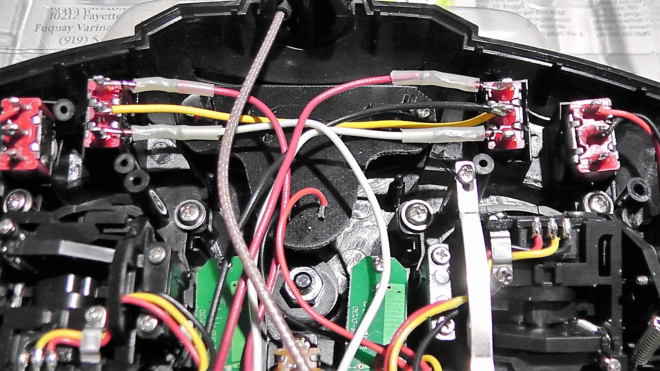

Using Devo7e with Deviation 5.0 Installed 2 ON OFF ON 3way toggles using instuctions from the wiki by straferr. Used 1n4148 diodes with band toward switch. followed wiring per wiki. edit hardware ini with notepad++ to read extra-switches=3x2. cannot see switches in monitor. Checked diodes with meter ok and checked wiring for shorts and continuity. What is next step?

1.) Do SW A0-2 and SW B0-2 appear in channel monitor (second page, scrolled down)?
2.) if yes, please post pictures of your wiring and soldering job

09 Mar 2017 19:06 - 09 Mar 2017 20:34 #60047
by enordaton
Replied by enordaton on topic extra-switches on Devo7e not recognized
here is wiring pics
Last edit: 09 Mar 2017 20:34 by enordaton. Reason: add ini
- Moeder
- Posts: 796
09 Mar 2017 22:06 #60054
by Moeder
Replied by Moeder on topic extra-switches on Devo7e not recognized
hmm..both soldering and ini content look fine to me, and I'm sure the ini is not named "hardware2.ini" when copied to the tx, or is it?
