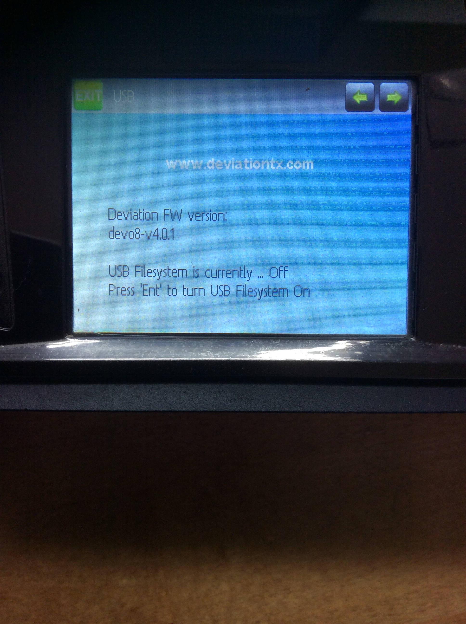

Hi All
Iinstulled the new ver 5.0.0 but when I look the deviation logo page in the transmitter screen it writen ver 4.0.1
Is it mean the upgrad didnot proccesed
How can I see if the v5.0.0 is instulled in my transmitter?

Replied by mwm on topic Devo s8 upgrad to version 5.0.0
Check the about page. If that says 4.0.1, you didn't upgrade. If that's the case, tell us exactly what you did and maybe we can figure out what went wrong.

Hi
So I downlowded the deviation-devo8-v5.0.0 zip file
Unziped the file and copied all files to my devo thet was concect to my pc via usb (I could see the old files)
So what I am missinig

Replied by Hr on topic Devo s8 upgrad to version 5.0.0
The problem solved, I forgot to Use the dfuse tool for upgrading .
