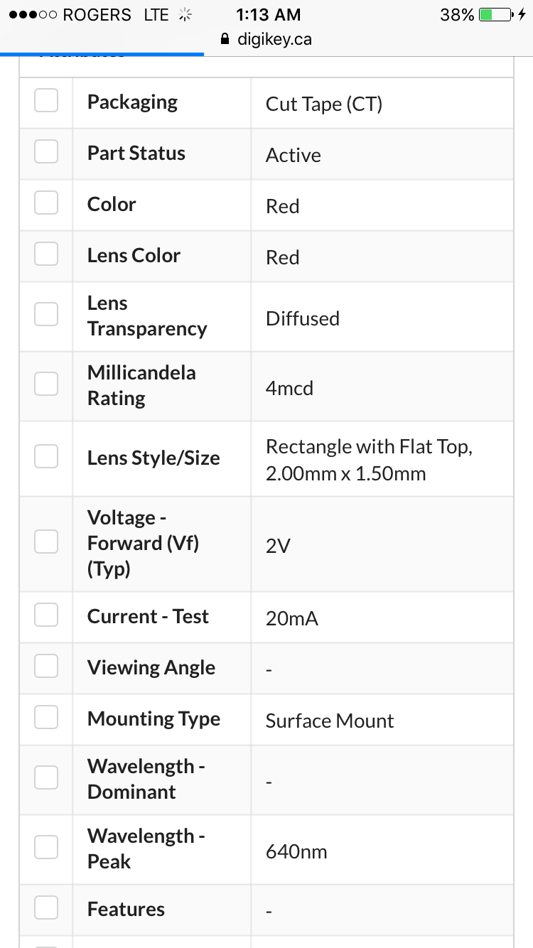

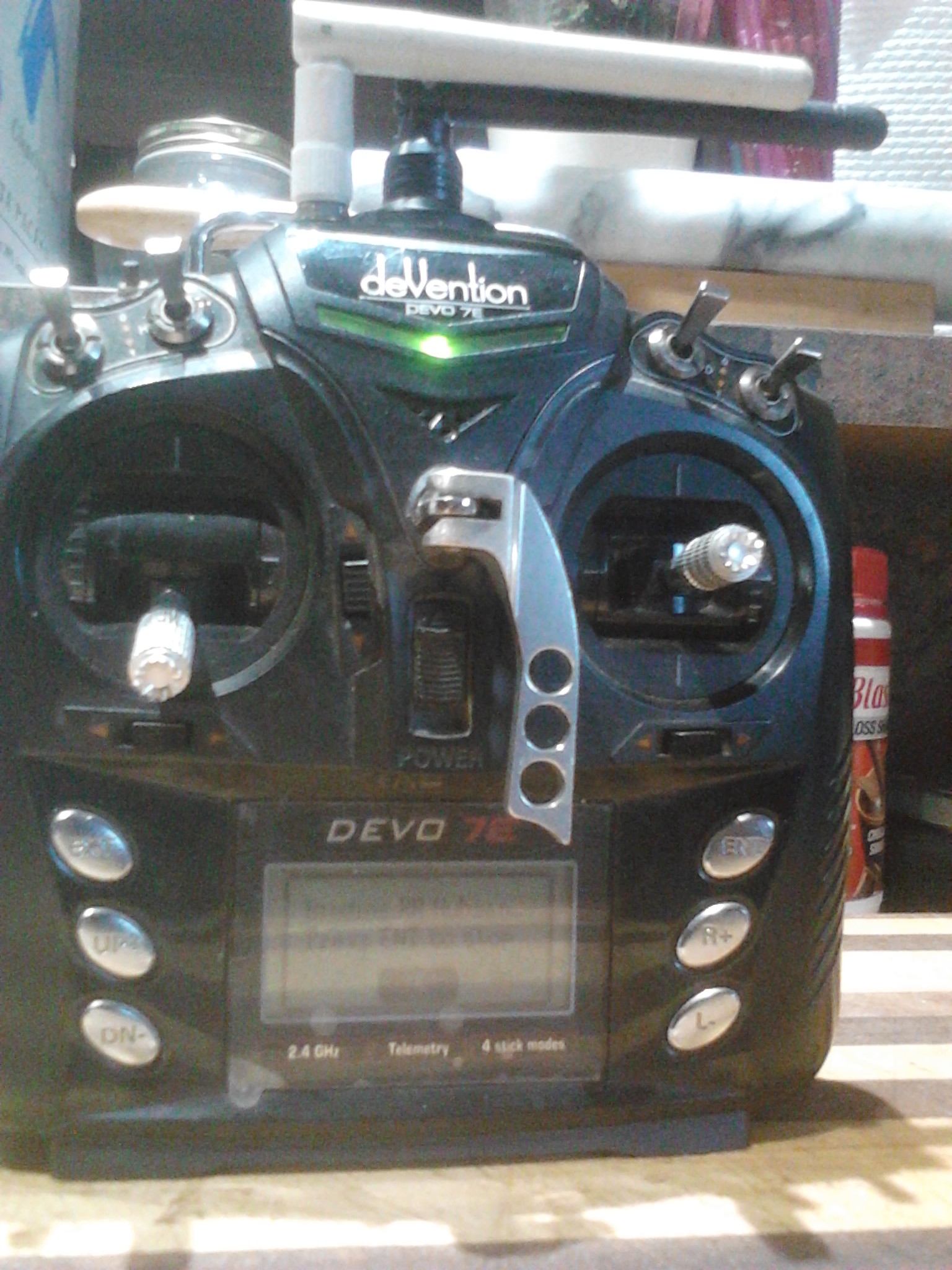

So these are the LED's I used, they are 2V forward. Can someone help me figure out the safest resistor to use and where to place it? So I have a wire going from the switch to the first LED a wire joining the 2 LED's then a wire going to ground on the board. I know you mentioned putting a resistor between the last LED and the ground but everything else Iv seen is telling me to put the resistor on the positive side. I probably have things confused, any clarity would be much appreciated!
Cheers!
Cheers!

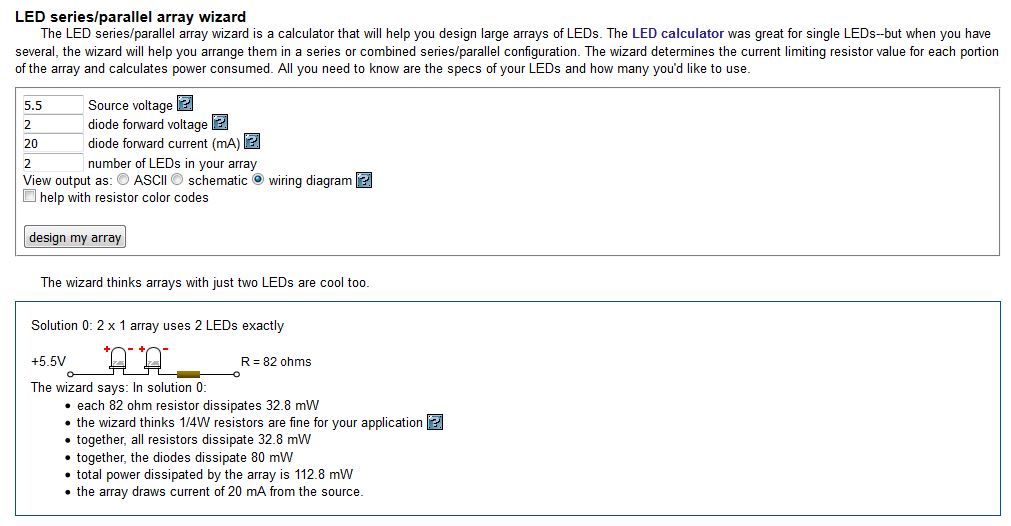

Thanks for the option MikefromGermany! I was hoping to find a solution I could add to my current installation. I will keep that option in mind for sure in case I do disassemble it all again. Any recommendations for a series circuit with only 2 2V 20mA LED's? Thanks for your time! Appreciate the feedback

Replied by MikefromGermany on topic Light on Devo 7e?
Do as Deal57 said above.
Use either:
led.linear1.org/led.wiz
or
ledcalc.com/#calc
For your application see below:
Use either:
or
ledcalc.com/#calc

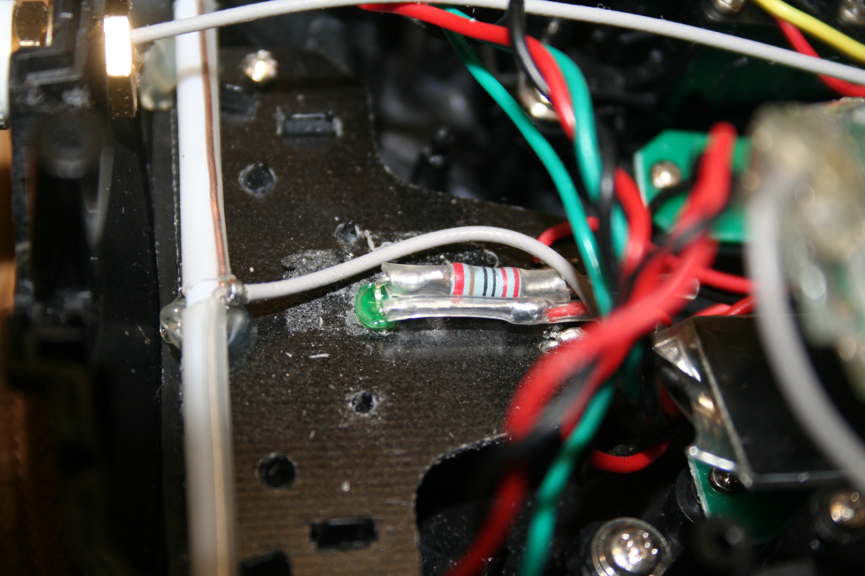

30 Mar 2017 22:34 #60955
by ClittleJ
Replied by ClittleJ on topic Light on Devo 7e?
Thanks again! You've been a ton of help. Installed the resistor today and bought a multimeter as well. Voltage at the switch showed as about 4.99V and on screen battery was showing 5.27 so they are close. Maybe there's a 5V regulator before the switch? At 5V in the calculation it showed a slightly smaller resistor, but I went with the 82ohm 1/4W one anyway for the 5.5V that I sometimes hit with a charge. I'm sure it should be fine.. Took that opportunity to clean up my amateur work a bit on the inside as well, since I hope this will be the last time I have to open in for a while.. lol. Looks a bit crazy inside but everything works!!
Cheers!

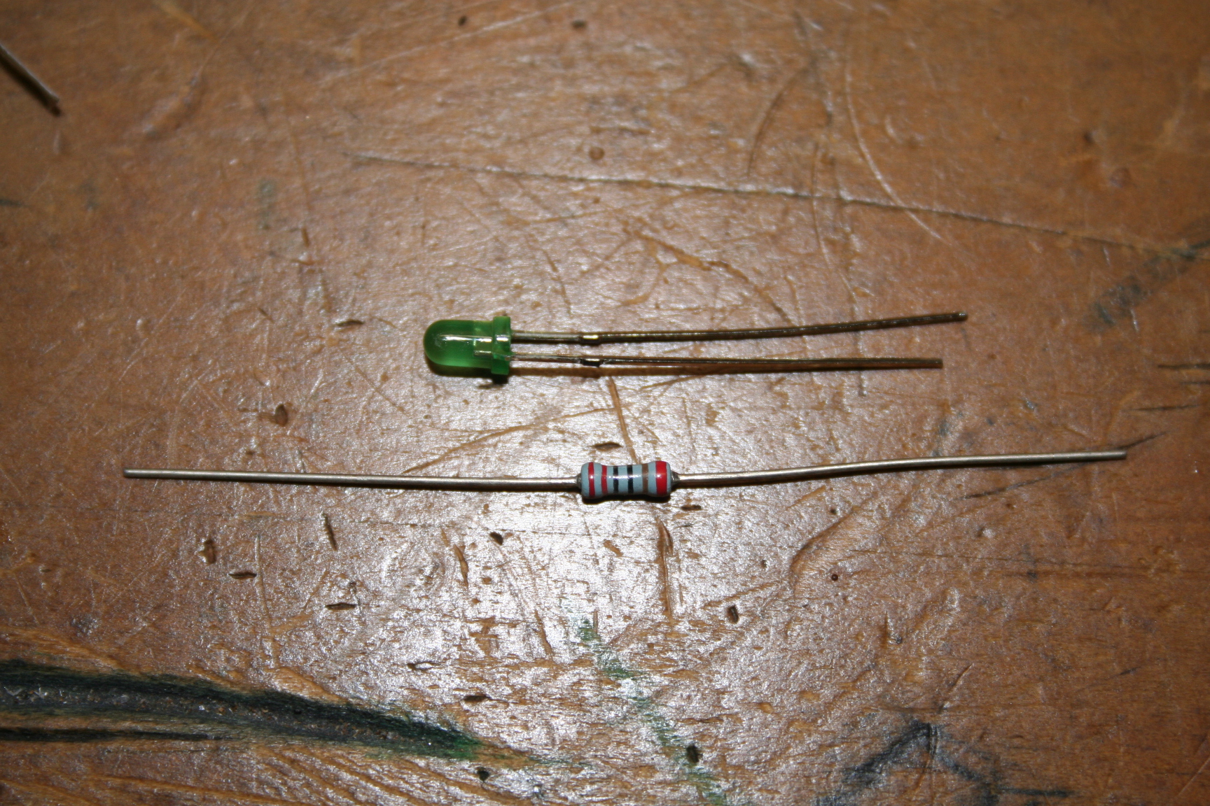

Replied by Gerry on topic Light on Devo 7e?
I have added one 3mm green led to my devo 7e. A bit less fiddly than trying to work with smd's.
1x 3mm green led
1x 220 ohm resister
a bit of heat shrink and wire
1x 3mm green led
1x 220 ohm resister
