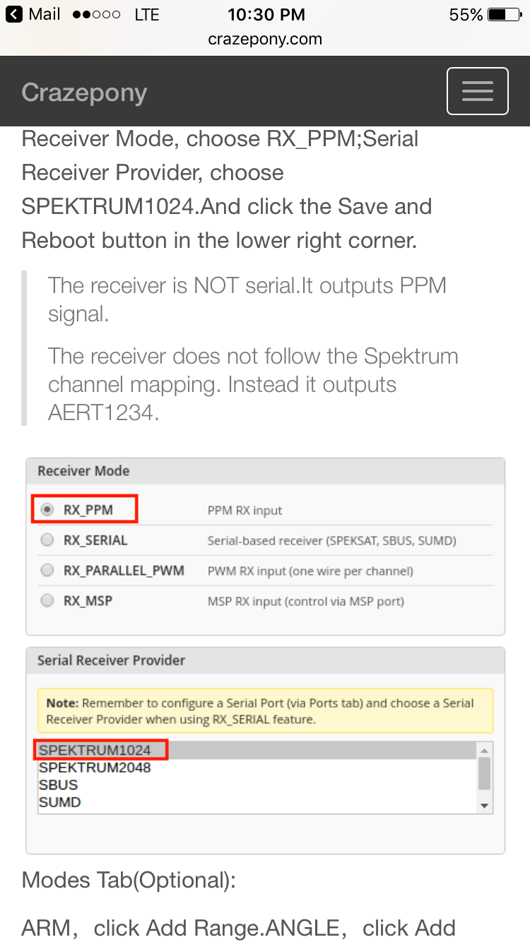

Im at work again so I can't check anything physically tonight, but I found info on the stock rx that's in the quad. It's a "native DSM receiver connected through PPM". I believe the setup in this pic is the stock setup that was on betaflight when I plugged it in, I'll confirm tomorrow. Thanks again!
