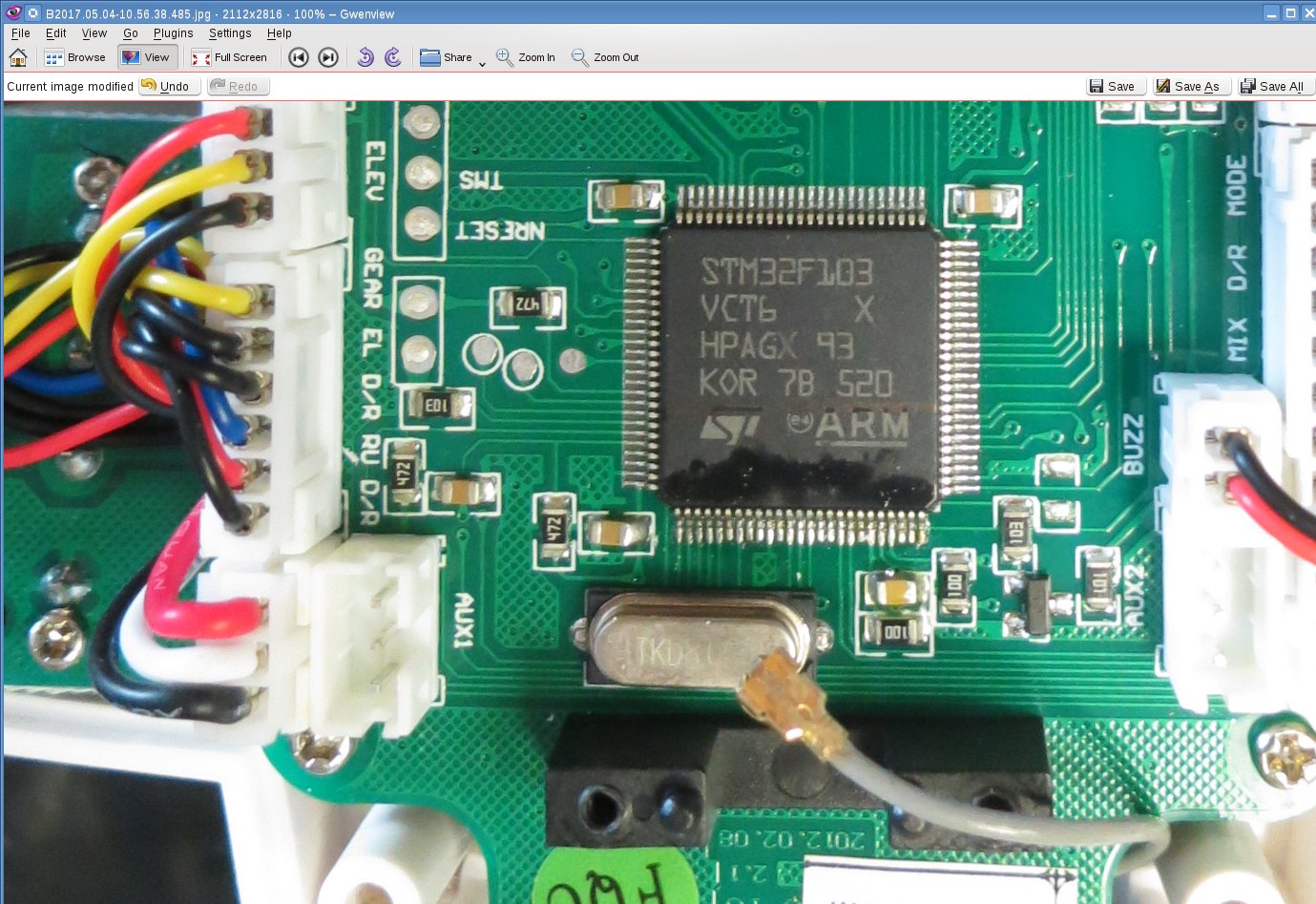

Thank you for your suggestions. I think, I have found something: before I started to build the 4in1-module into the devo 10, I made some photos: When looking into the attached photo, it seems to me, as someone would have done some corrections on the STM-processor: It seems, that the Pin 7 from the right bottom corner has a solder joint to pin 6. I will try to remove this joint and try again.
The picture shows the board with the original devo HF module removed (antenna connector is visible).
BTW: Also with the firmware 5.0, the coupling is the same. So, it seems definitely, that it is a hardware error.

Next two pins are right stick inputs (C2=pin17=horisontal and C3=pin18=vertical).
Last edit: 05 May 2017 09:40 by vlad_vy.

Replied by symfen on topic Devo 10: strange link between Thrust and Rudder
Do you have a schematic, so that I could check the pins? The solder joint that I see is on the horizontal side between 6 and 7 from right.
I have used solder wick to clean the contacts at the low side of the ARM-chip. After reinstall of the 4in1-module I got an error (CYSFR9... missing). But after once more dismounting and remounting, the deviation 5.0 worked with all 4 channels showing the right behaviour. It seems to me, that my Devo-10 has not been very carefully soldered (see photo: solder paste on the low side).
Problem: How to bind to Syma X5C (the protocol selected is the *SymaX, when pushing ENT on Re-Init, nothing happens. Is that another hardware problem?

I think you still have some hardware problems.
For example the flux residue can conduct, and explain your still existing link.
Try to clean the microcontroller's legs with alcohol.
To be honest those pots have low enough resistance (usually 5kOhm) so such small current leaks shouldn't exist until your wires and contacts are good.

Finally, I have found the error: today, I wanted to measure the voltages across the RUD-potentiometer. I used a very thin probe and injected it into the contacts of the RUD connector. I felt, that the contacts were moving slightly and after powering up, I realized, that the RUD behaves now as it should. For test, I removed the RUD connector completely: now, the RUD behaved exactly as in the first tests. So, my conclusion is: the RUD signal was induced by the trace from the adjacent TRU trace, which runs along on about 5-10 centimeters. Since this capacitive coupling is weak, but the ADC-Input of the processor has high impedance, the RUD behaved as reported earlier.
So, now, everything is working and I am finally capable of looking into the nice functionalities of Deviation (running the nightly build version 403c3b6).
