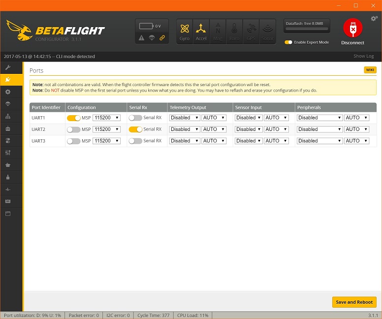

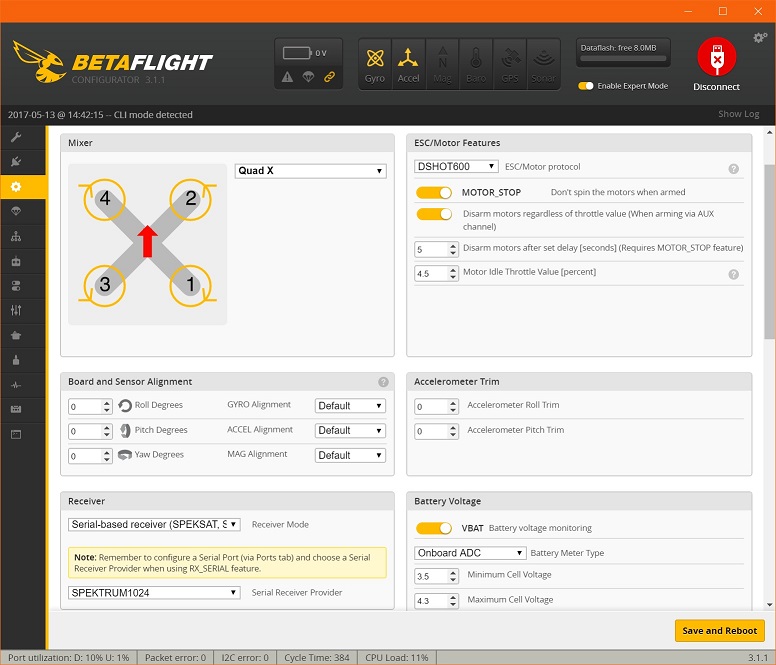

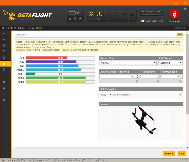

14 May 2017 00:52 - 14 May 2017 00:53 #62291 by Whatsinaname
Replied by Whatsinaname on topic Issues with DSMX?
Kingkong 90gt betaflight 3.1.6 - I still have to update it to the latest.
Uart, configuration, and rx tabs
I held the sticks and moved one of the aux switches to low position for the screenshot
Last edit: 14 May 2017 00:53 by Whatsinaname.
