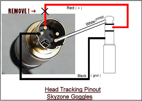

How I did it. I took a standard s-video cable, patched pin 4 to ground and pin 3 to signal on a 3.5mm mono plug. This connected the goggles to the DSC of the DEVO 10. I then used the following model file to control the Flysky reciever = name=FPV

BTW this file also puts ch5 (flaps for me) on the three position switch.
