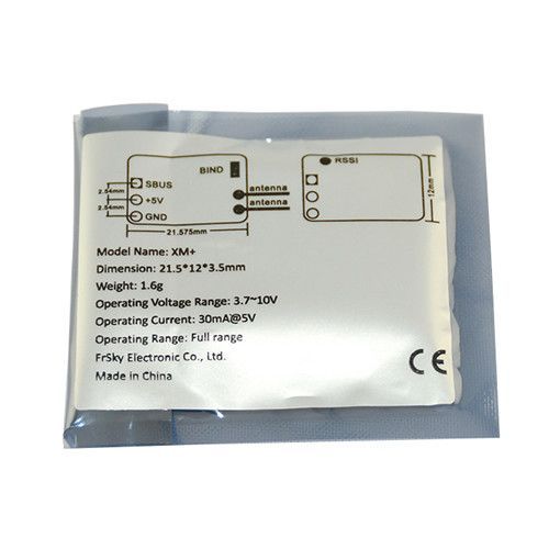

XM+ has no telemetry. It feeds RSSI to either an output pin on board or ch16 by flasing the appropriate FW. Take a look at XSR instead.

Need to solder a wire on the RX Frsky XM + Micro D16 or is there a slot on the rx?
And once I add this wire I connect it or on the flight controller?

Just to clarify:
if you use XM+ receiver, you can only display RSSI on OSD no matter what method you use
if you want to display RSSI on Devo radio transmitter with Deviation installed, get a XSR receiver or others with embedded telemetry
