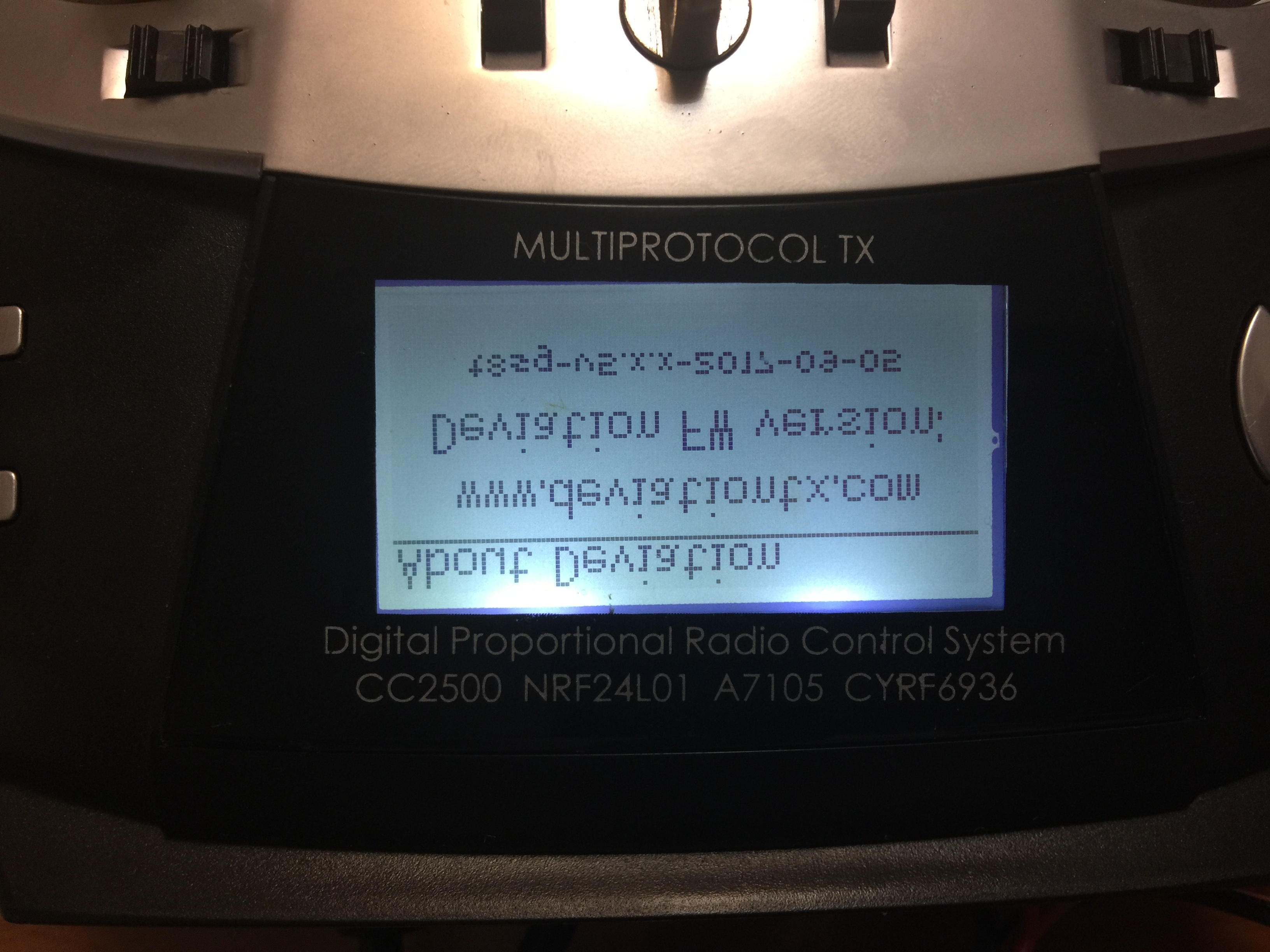

PhracturedBlue wrote: Do you want me to try to build you a firmware using their driver to get it so your screen is the right way around?
Hi PB,
T8FG maker provide source code and I upload to mediafire (13MB), it's based on Aug. 5 nightly build.
www.mediafire.com/file/r4sdzij87duli4r/deviation-0ac6094.rar
Could you please take a look at it ?
I flashed back to their FW and now my screen is OK!

vlad_vy wrote: T8FG source code has the only difference with Aug. 5 nightly build - two lines at "target\devo7e\lcd.c".
Thanks vlad_vy,I will try it after work. :cheer:

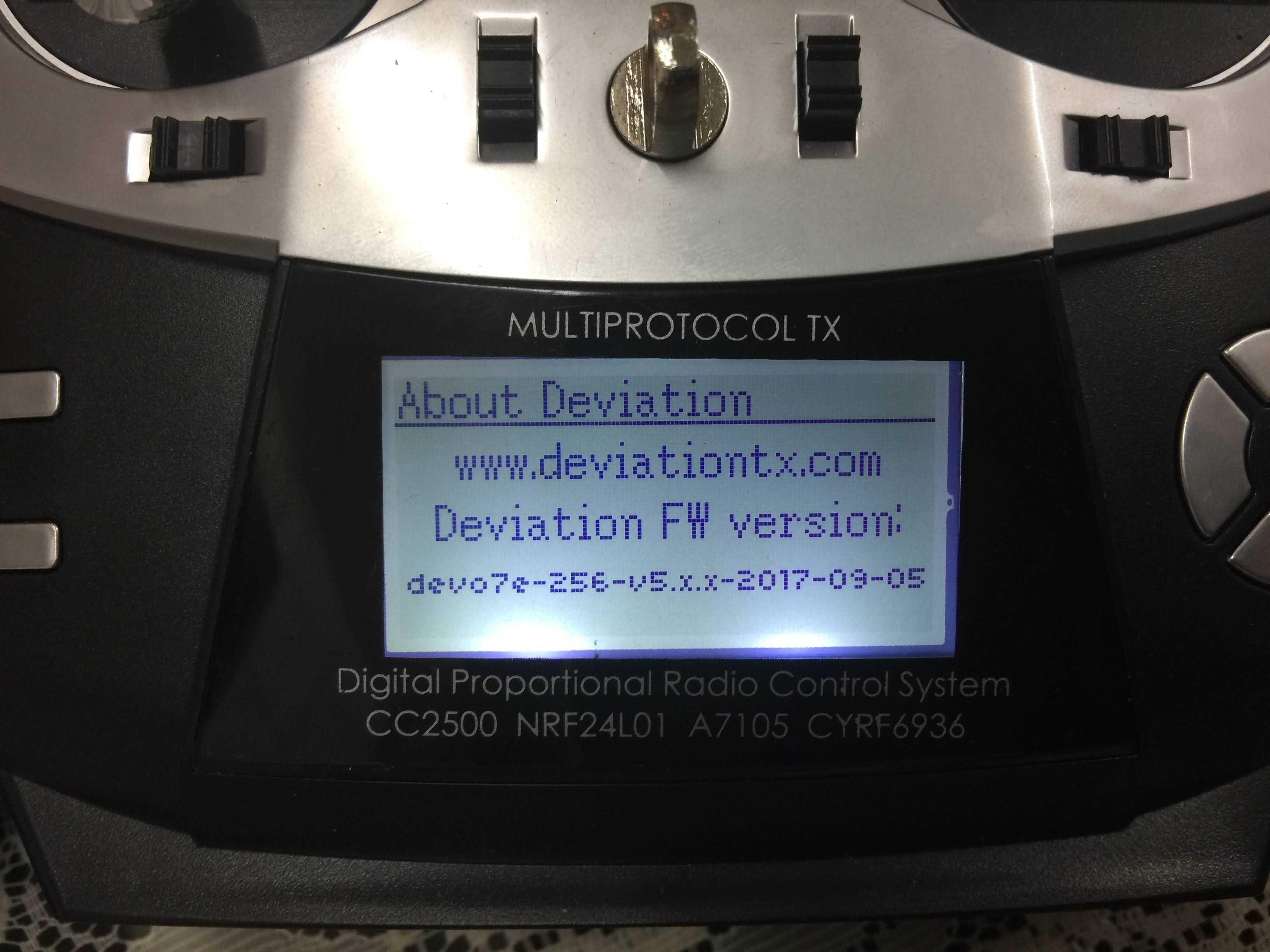

Thanks vlad_vy, it's working fine with your FW.
