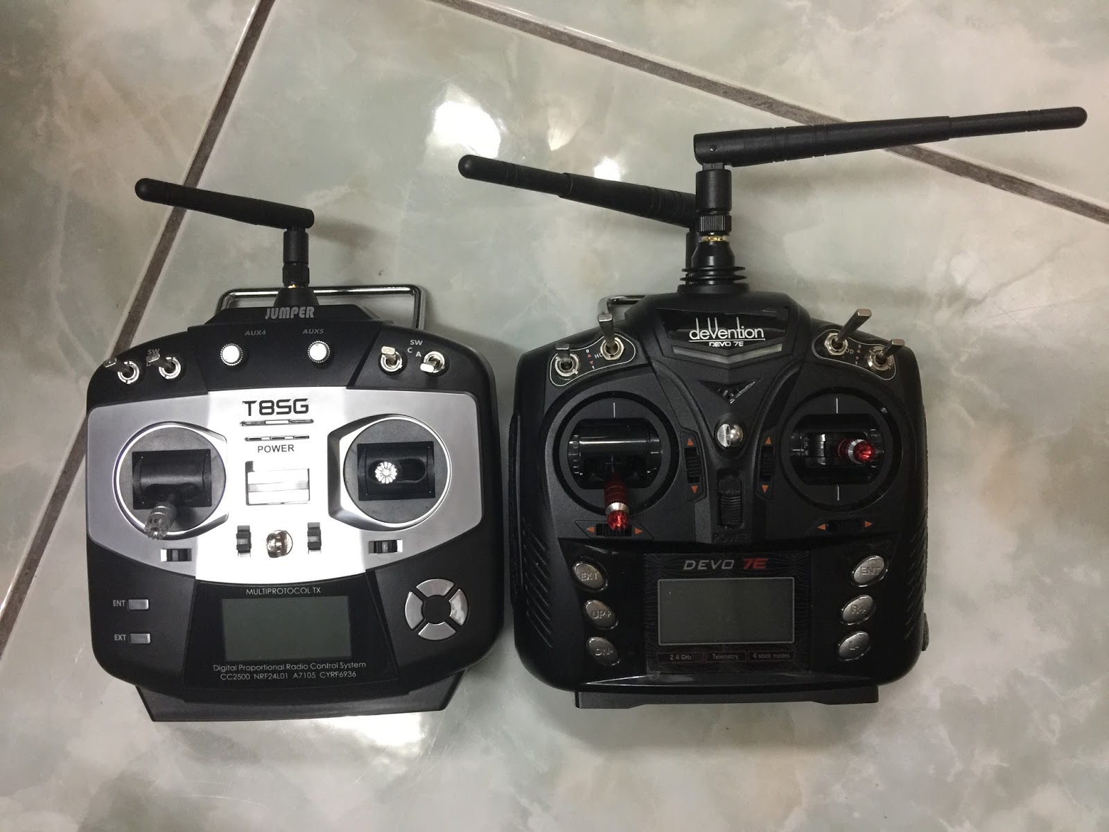

06 Sep 2017 17:49 - 06 Sep 2017 17:50 #64246 by Brainstorm
Replied by Brainstorm on topic New TX from Banggood
aMax wrote: Is this size comparison real? Quite a big radio.
img09.banggood.com/forum_images/20170906...0906035921_53229.jpg
aMax: That size comparison is an inaccurate photo montage. The picture below offers a better comparison with the compact Devo 7e, which is much smaller than Taranis X9D+ and QX7.
Last edit: 06 Sep 2017 17:50 by Brainstorm.

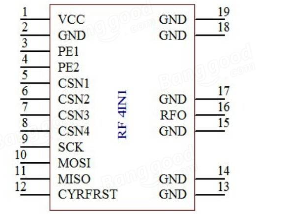

07 Sep 2017 02:47 #64257 by dc59
Jumper want to use unused MCU pin to control 4-in-1 module antenna switch (PE1/PE2) ,
they think it would be more stable for all system , they can change PCB layout no problem ,
but it's need firmware support !
BTW, Which pins are suitable for PE1/PE2 ? any suggestion ?
07 Sep 2017 04:16 #64258 by RoGuE_StreaK
Replied by RoGuE_StreaK on topic New TX from Banggood
Does the 4-in-1 module they are using have an onboard MCU that could handle that via the Chip Select, or don't they have access to the module production? Or doesn't the onboard MCU have enough spare pins?
I don't know what the chip select lines look like (never installed a module), but I'm guessing it could also be done with a simple logic switch chip driven by these lines?
statusPE1PE2
A7105 RF signal to antenna00
CC2500 RF signal to antenna01
NRF24L01 RF signal to antenna10
CYRF6936 RF signal to antenna11

07 Sep 2017 04:29 - 07 Sep 2017 04:35 #64260 by vlad_vy
Devo 4in1 module has chip select lines routed to simple logic switch chip with two outputs routed to PE1 and PE2.
Last edit: 07 Sep 2017 04:35 by vlad_vy.

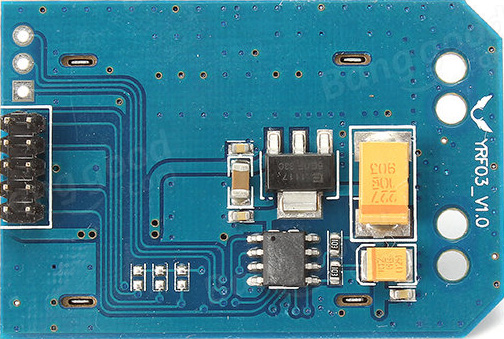

07 Sep 2017 05:12 - 07 Sep 2017 05:20 #64261 by RoGuE_StreaK
The above was found as a reference in the standalone multimodule, here's an example:
Multiprotocol module (Flysky Frsky Devo DSM2)
That was the only place I found that referenced seperate controls for PE1 / PE2, so maybe they are using a partial board from this? Actually, the pins on the shielded module part look identical to the ones shown on the TX board here... vlad, any info on which logic chip is used?
EDIT: OK looks like they both use the same shielded module, but the logic chip is external to it, so would just need to be added to the TX board
have I proven my worth yet for a freebie?
Last edit: 07 Sep 2017 05:20 by RoGuE_StreaK.
07 Sep 2017 05:24 - 07 Sep 2017 05:46 #64262 by vlad_vy
I don't know the chip, marking is scraped off on all Devo 4in1 modules. The same thing for 4-way RF switch inside 4in1 module.
Last edit: 07 Sep 2017 05:46 by vlad_vy.
