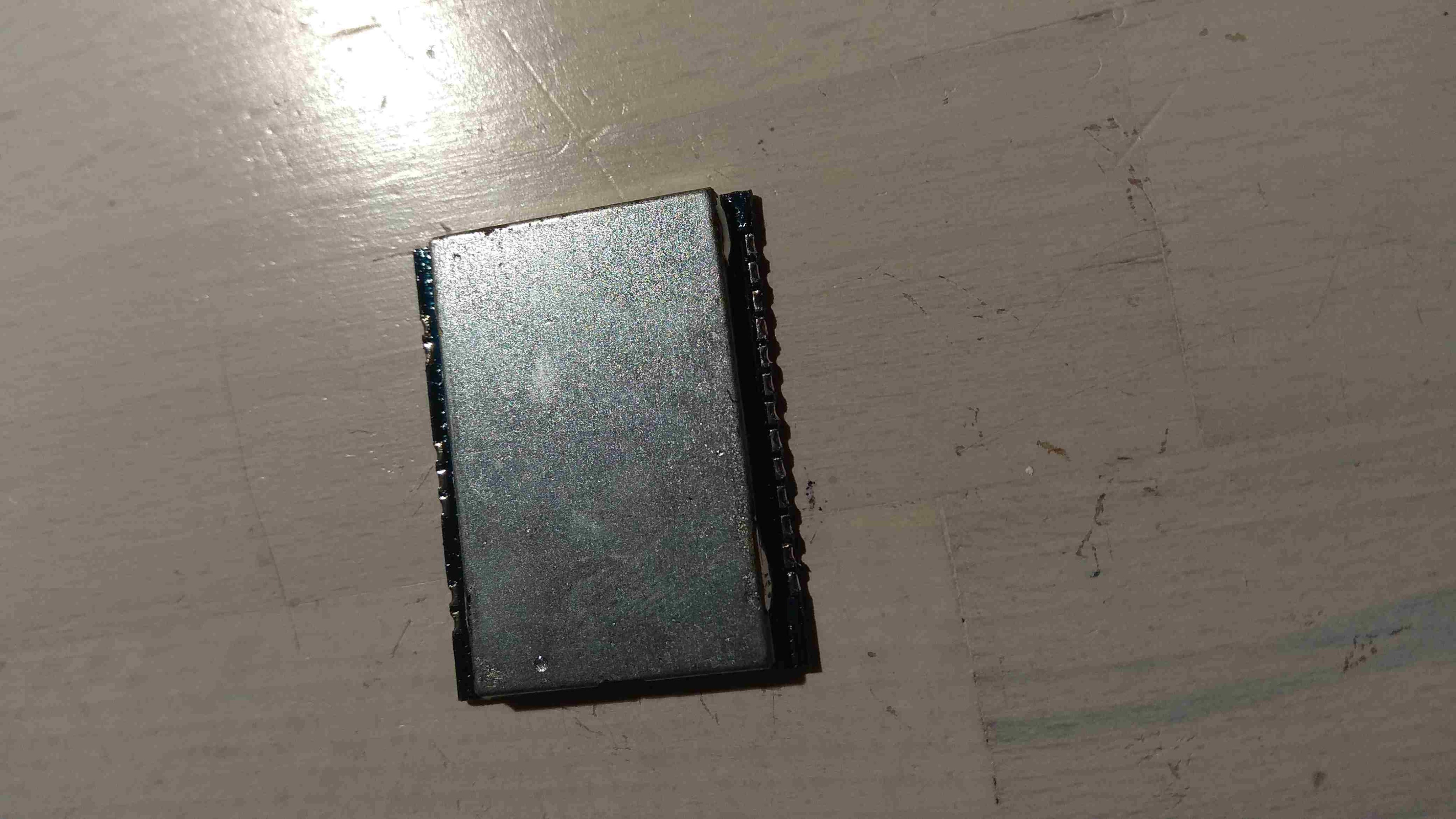

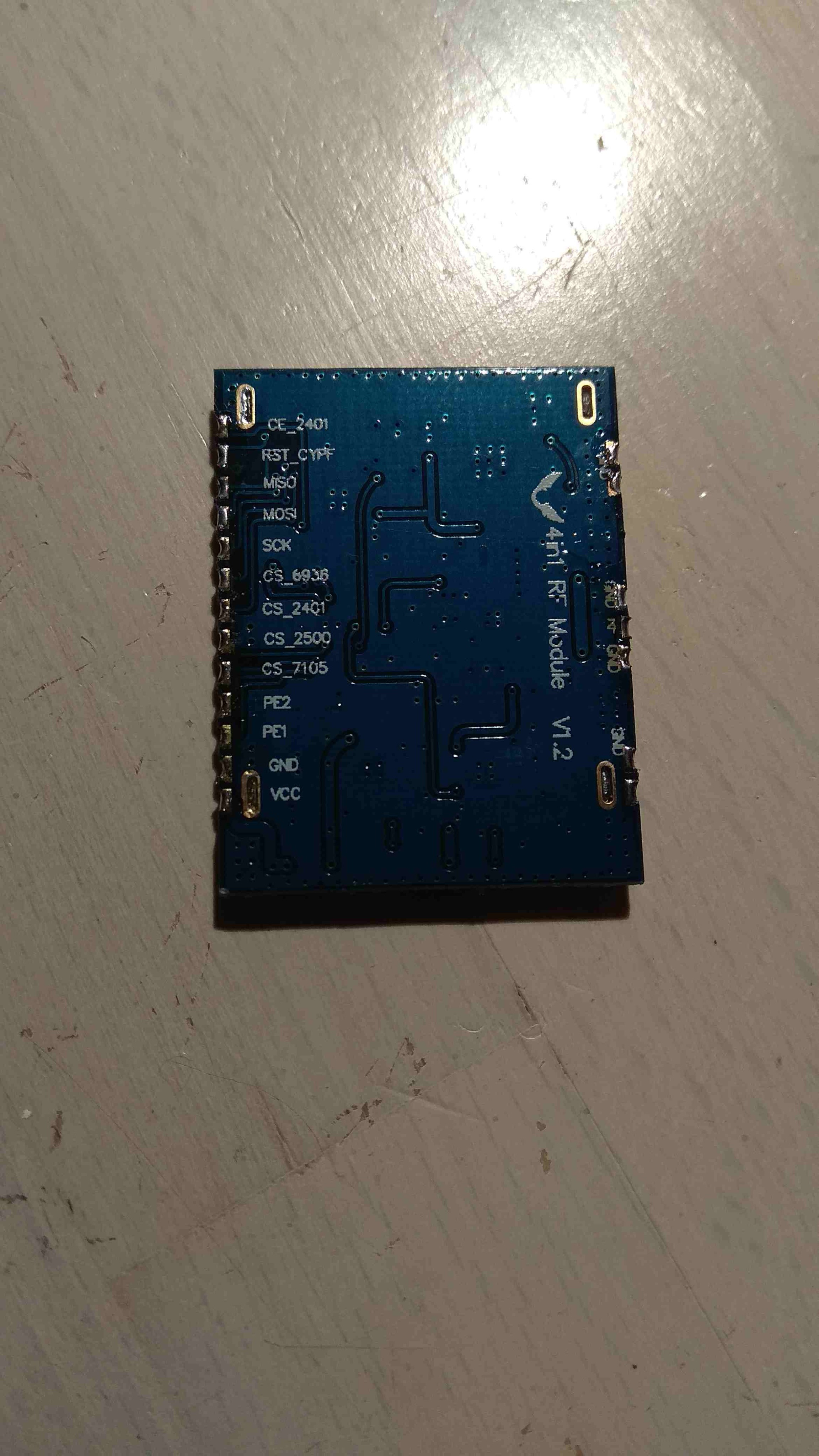

06 Mar 2020 19:58 #76035 by SirDomsen
Hi guys, sorry for jumping in.
I have a slightly OT question but hope it's OK to ask it here:
I want to use the tx module from a dead T8SG V1 in a Devo10. Not sure what to do with the pins called PE1 and PE2? From what I read in this thread here, I believe it's used for antenna switching? (How) are those pins wired in T8SG? Are they used? If so, how to wire/use those pins in the Devo10?
Tia
Domsen
07 Mar 2020 06:09 - 07 Mar 2020 06:15 #76038 by vlad_vy
It can't be used directly. PE1 and PE2 is for switching PA+LNA and antenna between RF chips. I think in T8SG there is chip that switching these lines. In "Devo 4in1" board also there is 8pin chip to switching these lines.
Truth table:
status______________________PE1_PE2
A7105 RF signal to antenna_____0____0
CC2500 RF signal to antenna____0____1
NRF24L01 RF signal to antenna__1____0
CYRF6936 RF signal to antenna__1____1
Last edit: 07 Mar 2020 06:15 by vlad_vy.
07 Mar 2020 08:21 #76039 by SirDomsen
Thanks for your reply. Got it so far.
But based on which signals is the PE lines going to be switched, assuming the switch chip is a simple logic chip? Based on CS signals? Is the logic above valid for Devo 4in1 only or valid for the T8SG module as well?
07 Mar 2020 08:24 #76040 by vlad_vy
I don't know how it work. The logic is for 4in1 module, it used in both T8SG and Devo 4in1.
