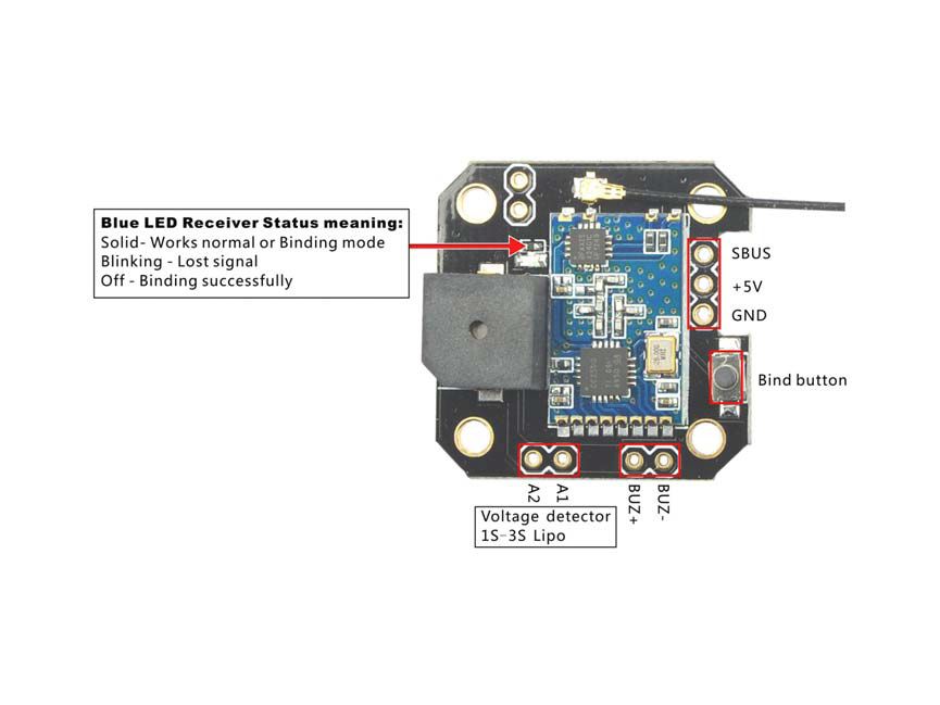

19 Sep 2017 05:09 - 19 Sep 2017 05:11 #64497
Replied by vlad_vy on topic Off topic: Aurora 100 motors don't spin up
Last edit: 19 Sep 2017 05:11 by vlad_vy.
19 Sep 2017 05:15 #64498
Replied by FDR on topic Off topic: Aurora 100 motors don't spin up
Wow, thanks!
