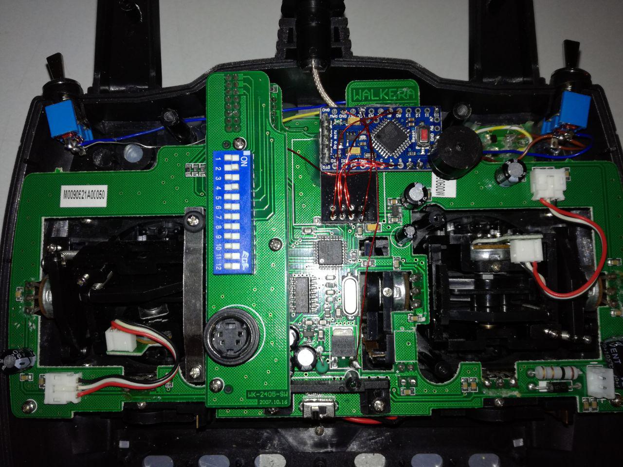

Hy together!
I have two Walkera 2401 Transmitters lying around , that i want donate to some childs in the neighborhood.
The gimbals are really good.
I have ordered a bunch of NRF24 modules and want to install it beside an arduino in the transmitters, using goebishs multipro code.
https://github.com/goebish/nrf24_multipro
i think this should work.
The problem is, that the TXs have a 8 channel PPM signal, but only the first 4 are used for the Gimbals.
No way to use a switch via ppm.
Unfortunately code is way to complex for me.
Anyone interested to help me with changing the code, so we can use some switches directly connected to the arduino?
In the meantime i will build it as 4 Channel version...

04 Nov 2017 15:44 #65502 by Wene001
Replied by Wene001 on topic offtopic: code help with goebish multipro
Thanks for the tips.
First one is ready.
I`ve implemented two switches for Ch5 Ch6, and two momentary switches(one for Bind/reset via AUX8)
I coded some switchable sort of expo to handle silverized Acro Quads with high rates.
If (compensated) telemetry voltage (Siverized Bayang) goes under 3.5 Volts the beeper gives Alarm.
It was necessary to code subtrim to get the Sticks center to perfect 1500us.
In the end a perfekt Transmitter for most of the China Toys.

    if(ppm[RUDDER] < PPM_MIN_COMMAND && ppm[AILERON] < PPM_MIN_COMMAND) // rudder left + aileron left
        current_protocol = PROTO_BAYANG_SILVERWARE; // Bayang protocol for Silverware with frsky telemetry
    else if(ppm[RUDDER] < PPM_MIN_COMMAND)   // Rudder left
        set_txid(true);                      // Renew Transmitter ID
    // Rudder right + Aileron right + Elevator down
    else if(ppm[RUDDER] > PPM_MAX_COMMAND && ppm[AILERON] > PPM_MAX_COMMAND && ppm[ELEVATOR] < PPM_MIN_COMMAND)
        current_protocol = PROTO_E010; // EAchine E010, NiHui NH-010, JJRC H36 mini
    // Rudder right + Aileron right + Elevator up
    else if(ppm[RUDDER] > PPM_MAX_COMMAND && ppm[AILERON] > PPM_MAX_COMMAND && ppm[ELEVATOR] > PPM_MAX_COMMAND)
        current_protocol = PROTO_FQ777124; // FQ-777-124
    // Rudder right + Aileron left + Elevator up
    else if(ppm[RUDDER] > PPM_MAX_COMMAND && ppm[AILERON] < PPM_MIN_COMMAND && ppm[ELEVATOR] > PPM_MAX_COMMAND)
        current_protocol = PROTO_YD717; // Cheerson CX-10 red (older version)/CX11/CX205/CX30, JXD389/390/391/393, SH6057/6043/6044/6046/6047, FY326Q7, WLToys v252 Pro/v343, XinXun X28/X30/X33/X39/X40
    // Rudder right + Aileron left + Elevator down
    else if(ppm[RUDDER] > PPM_MAX_COMMAND && ppm[AILERON] < PPM_MIN_COMMAND && ppm[ELEVATOR] < PPM_MIN_COMMAND)
        current_protocol = PROTO_KN; // KN (WLToys variant) V930/931/939/966/977/988
    // Rudder right + Elevator down
    else if(ppm[RUDDER] > PPM_MAX_COMMAND && ppm[ELEVATOR] < PPM_MIN_COMMAND)
        current_protocol = PROTO_HISKY; // HiSky RXs, HFP80, HCP80/100, FBL70/80/90/100, FF120, HMX120, WLToys v933/944/955 ...
    // Rudder right + Elevator up
    else if(ppm[RUDDER] > PPM_MAX_COMMAND && ppm[ELEVATOR] > PPM_MAX_COMMAND)
        current_protocol = PROTO_SYMAXOLD; // Syma X5C, X2 ...
    else if(ppm[RUDDER] > PPM_MAX_COMMAND && ppm[AILERON] > PPM_MAX_COMMAND)
        current_protocol = PROTO_MJX; // MJX X600, other sub protocols can be set in code
    else if(ppm[RUDDER] > PPM_MAX_COMMAND && ppm[AILERON] < PPM_MIN_COMMAND)
        current_protocol = PROTO_H8_3D; // H8 mini 3D, H20 ...
    // Elevator down + Aileron right
    else if(ppm[ELEVATOR] < PPM_MIN_COMMAND && ppm[AILERON] > PPM_MAX_COMMAND)
        current_protocol = PROTO_YD829; // YD-829, YD-829C, YD-822 ...
    // Elevator down + Aileron left
    else if(ppm[ELEVATOR] < PPM_MIN_COMMAND && ppm[AILERON] < PPM_MIN_COMMAND)
        current_protocol = PROTO_SYMAX5C1; // Syma X5C-1, X11, X11C, X12
    // Elevator up + Aileron right
    else if(ppm[ELEVATOR] > PPM_MAX_COMMAND && ppm[AILERON] > PPM_MAX_COMMAND)
        current_protocol = PROTO_BAYANG;    // EAchine H8(C) mini, BayangToys X6/X7/X9, JJRC JJ850 ...
    // Elevator up + Aileron left
    else if(ppm[ELEVATOR] > PPM_MAX_COMMAND && ppm[AILERON] < PPM_MIN_COMMAND)
        current_protocol = PROTO_H7;        // EAchine H7, MT99xx
    // Elevator up
    else if(ppm[ELEVATOR] > PPM_MAX_COMMAND)
        current_protocol = PROTO_V2X2;       // WLToys V202/252/272, JXD 385/388, JJRC H6C ...
    // Elevator down
    else if(ppm[ELEVATOR] < PPM_MIN_COMMAND)
        current_protocol = PROTO_CG023;      // EAchine CG023/CG031/3D X4, (todo :ATTOP YD-836/YD-836C) ...
    // Aileron right
    else if(ppm[AILERON] > PPM_MAX_COMMAND)
        current_protocol = PROTO_CX10_BLUE;  // Cheerson CX10(blue pcb, newer red pcb)/CX10-A/CX11/CX12 ...
    // Aileron left
    else if(ppm[AILERON] < PPM_MIN_COMMAND)
        current_protocol = PROTO_CX10_GREEN;  // Cheerson CX10(green pcb)...
    // read last used protocol from eeprom
    else
        current_protocol = constrain(EEPROM.read(ee_PROTOCOL_ID),0,PROTO_END-1);
    // update eeprom
    EEPROM.update(ee_PROTOCOL_ID, current_protocol);
    // wait for safe throttle
    while(ppm[THROTTLE] > PPM_SAFE_THROTTLE) {
        delay(100);
        update_ppm();
void init_protocol()
    switch(current_protocol) {
        case PROTO_CG023:
        case PROTO_YD829:
            CG023_init();
            CG023_bind();
            break;
        case PROTO_V2X2:
            V2x2_init();
            V2x2_bind();
            break;
        case PROTO_CX10_GREEN:
        case PROTO_CX10_BLUE:
            CX10_init();
            CX10_bind();
            break;
        case PROTO_H7:
            H7_init();
            H7_bind();
            break;
        case PROTO_BAYANG:
        case PROTO_BAYANG_SILVERWARE:
            Bayang_init();
            Bayang_bind();
            break;
        case PROTO_SYMAX5C1:
        case PROTO_SYMAXOLD:
            Symax_init();
            break;
        case PROTO_H8_3D:
            H8_3D_init();
            H8_3D_bind();
            break;
        case PROTO_MJX:
        case PROTO_E010:
            MJX_init();
            MJX_bind();
            break;
        case PROTO_HISKY:
            HiSky_init();
            break;
        case PROTO_KN:
            kn_start_tx(true); // autobind
            break;
        case PROTO_YD717:
            YD717_init();
            break;
        case PROTO_FQ777124:
            FQ777124_init();
            FQ777124_bind();
            break;
// update ppm values out of ISR
void update_ppm()
    for(uint8_t ch=0; ch<CHANNELS; ch++) {
        ATOMIC_BLOCK(ATOMIC_RESTORESTATE) {
            ppm[ch] = Servo_data[ch];
    ppm[ELEVATOR] = ppm[ELEVATOR]-23; //Subtrim Elevator
    ppm[AILERON] = ppm[AILERON]+38; //Subtrim Aileron
    ppm[RUDDER] = ppm[RUDDER]-10; //Subtrim Rudder
      Serial.print(" ELEVATOR ");
      Serial.print(ppm[ELEVATOR]);
      Serial.print(" AILERON ");
      Serial.print(ppm[AILERON]);
      Serial.print(" THROTTLE ");
      Serial.print(ppm[THROTTLE]);
      Serial.print(" RUDDER ");
      Serial.println(ppm[RUDDER]);
      Serial.print(" telemetry_data.volt1 ");
      Serial.println(telemetry_data.volt1);
#ifdef SPEKTRUM
        ppm[ch] = constrain(map(ppm[ch],1130,1870,PPM_MIN,PPM_MAX),PPM_MIN,PPM_MAX);
        if(digitalRead(6) == LOW) {
          if(ch == ELEVATOR || ch == AILERON || ch == RUDDER) {
            if(ppm[ch] < 1250)
               ppm[ch] = ppm[ch]/2+ppm[ch]-500;
            else if(ppm[ch] > 1750)
               ppm[ch] = ppm[ch]/2+ppm[ch]-1000;
            else
               ppm[ch] = ppm[ch]/2+750;
#endif
    ppm[AUX1] = digitalRead(6) == HIGH ? 2000 : 1000;
    ppm[AUX2] = digitalRead(8) == LOW ? 2000 : 1000;
    ppm[AUX3] = digitalRead(10) == LOW ? 2000 : 1000;
    ppm[AUX5] = digitalRead(6) == LOW ? 2000 : 1000;
    ppm[AUX8] = digitalRead(7) == LOW ? 2000 : 1000;
void ISR_ppm()
    #if F_CPU == 16000000
        #define PPM_SCALE 1L
    #elif F_CPU == 8000000
        #define PPM_SCALE 0L
    #else
        #error // 8 or 16MHz only !
    #endif
    static unsigned int pulse;
    static unsigned long counterPPM;
    static byte chan;
    counterPPM = TCNT1;
    TCNT1 = 0;
    ppm_ok=false;
    if(counterPPM < 510 << PPM_SCALE) {  //must be a pulse if less than 510us
        pulse = counterPPM;
    else if(counterPPM > 1910 << PPM_SCALE) {  //sync pulses over 1910us
        chan = 0;
    else{  //servo values between 510us and 2420us will end up here
        if(chan < CHANNELS) {
            Servo_data[chan]= constrain((counterPPM + pulse) >> PPM_SCALE, PPM_MIN, PPM_MAX);
            if(chan==3)
                ppm_ok = true; // 4 first channels Ok
        chan++;
void Alarm()
  unsigned long currentMillis = millis();
  if (currentMillis - previousMillis >= interval-beep) {
    tone(buzzer, freq);
    if (currentMillis - previousMillis >= interval) {
    // save the last time you beeped
    previousMillis = currentMillis;
    noTone(buzzer);
Last edit: 04 Nov 2017 16:26 by Wene001.
