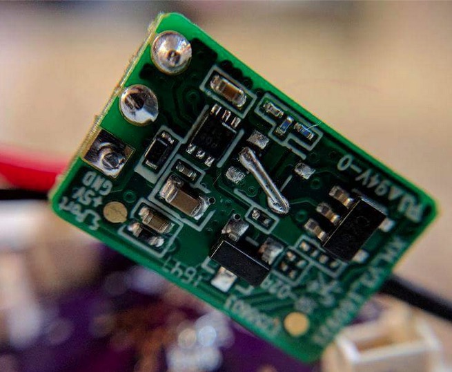

I still have to actually use it in a build, sort out some travel adjustments and an arming switch but all flight control inputs are registering in the MultiWii GUI so I am confident that there will be no issues. I removed the inversion chip from the XM (image courtesy of Charlie Stevenson) and bridged two pads as advised by Gary Baynes on the AW FC Fan Club Facebook page.
