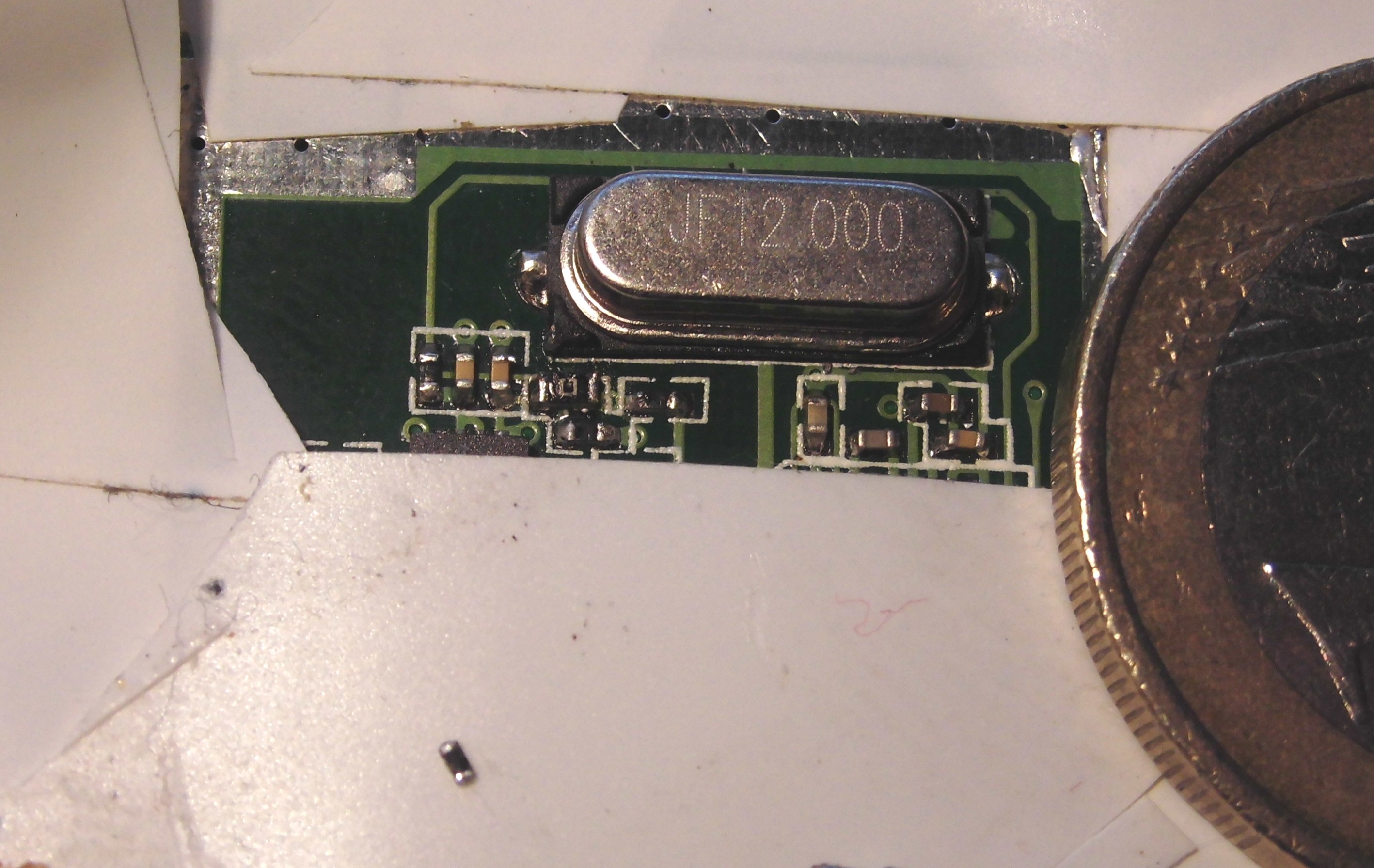

If you are 100% sure your conductive ink works, give it a try. Otherwise I would recommend a mod with a zero ohm
bridge which can be in size even taller than the resistor,.easyly to solder....
Range is 350 up to ???, depends on the receiver. With a 615X I got 350m and with a LNA receiver nearly 500m ..on ground test!

Thanks for the picture next to the euro. It was hard for me to get an idea of the size, so it really helps a lot!
It is really small, and i am scared i will desolder different components, or mess up in a different way, my hand isnt that steady.

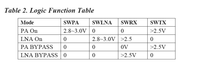

What ever you do, as long as you reach the goal for the given voltage in the logic table.....
Search for a pdf > RDAT212.pdf.
