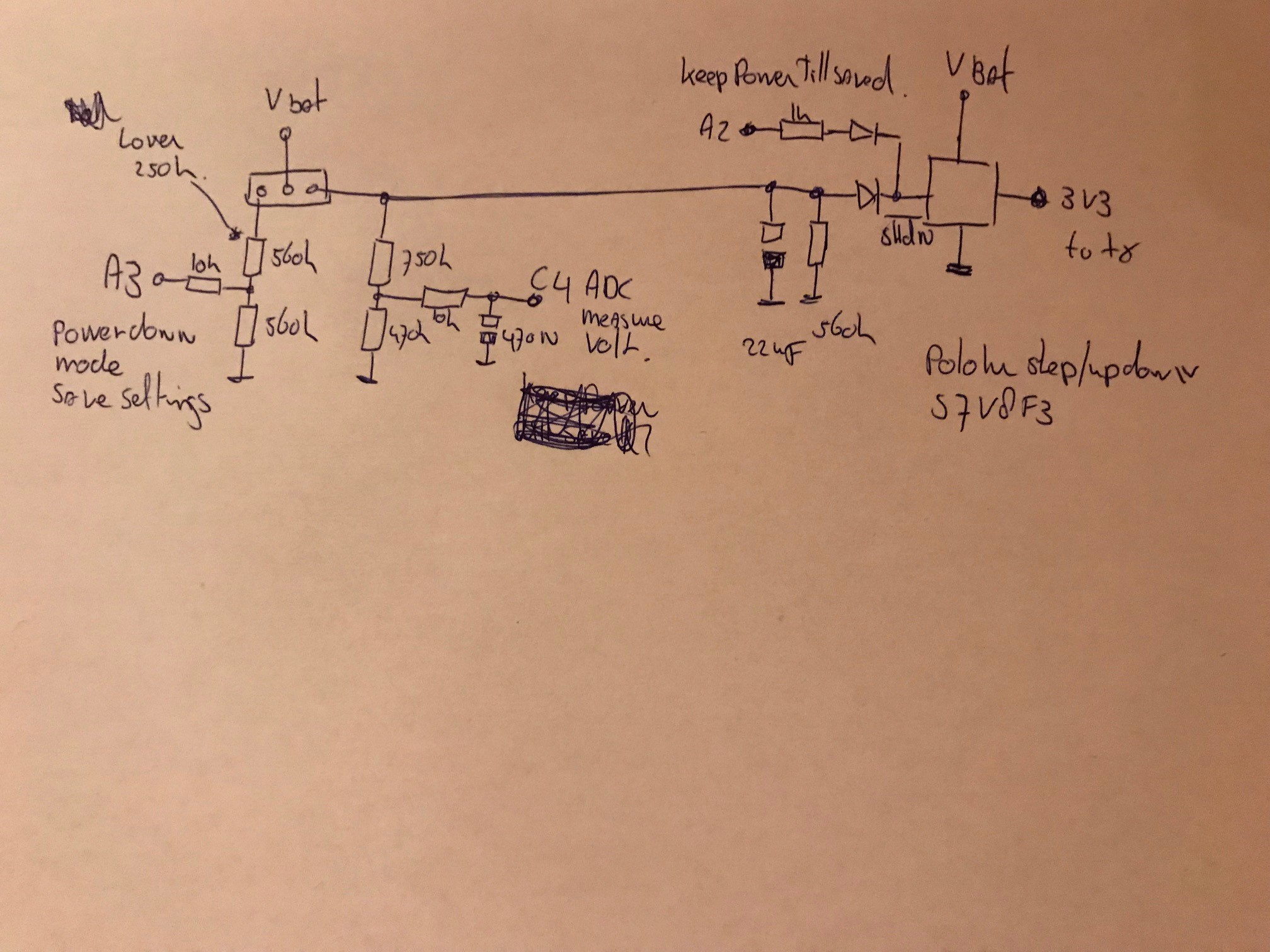

I am trying to mod my devo 7e in order to power from 1s liion using pololu step up down.
As soon as devo displays voltage around or lower than 4.5Volt, I get "battery too low! Can't save. The buzzer and circuitry starts to oscillate. This while the power still is perfectly 3v3 at the cpu.
I would like to have can't save message around 2.8V.
Some idea for more simple power circuitry, then use 1 or 2 parallel 18650 with protection and usb charge module.

@Fernandez - As I was dealing with the batt too low message on the T8SG, I had to go into tx.ini with Notepad++ and edit batt_critical=3900 to a much lower value to keep that warning from coming up. I am flying with batt_critical=2800 right now. Also I did observe that you cannot set batt_alarm to anything below 3300 using the transmitter menu buttons, but again using Notepad++ to edit tx.ini works. I was able to lower batt_alarm to 3volts by directly editing batt_alarm=3000. Note that the batt_critical low value will keep the warning message from coming up, but on the T8SG the power down configuration save will still fail for voltages below 3.8 or 3.75volts. To get around that you need to modify the 560K-560K ohm voltage divider. 240K-560K ohms works for me and allows the T8SG configuration save to work to something below 2.8volts, consistent with the batt_critical that I am using.

ramunas wrote: @Fernandez - As I was dealing with the batt too low message on the T8SG, I had to go into tx.ini with Notepad++ and edit batt_critical=3900 to a much lower value to keep that warning from coming up. I am flying with batt_critical=2800 right now. Also I did observe that you cannot set batt_alarm to anything below 3300 using the transmitter menu buttons, but again using Notepad++ to edit tx.ini works. I was able to lower batt_alarm to 3volts by directly editing batt_alarm=3000. Note that the batt_critical low value will keep the warning message from coming up, but on the T8SG the power down configuration save will still fail for voltages below 3.8 or 3.75volts. To get around that you need to modify the 560K-560K ohm voltage divider. 240K-560K ohms works for me and allows the T8SG configuration save to work to something below 2.8volts, consistent with the batt_critical that I am using.
Myself I have U7E, but it is moreless identical to the jumper. I use direfctly a single pololu step up step down 3v3 regulator connected to two 18650 liion in parallel.
The batteries I connected them to this module to charge and protect the cell against overcharge and discharge.
www.banggood.com/5Pcs-USB-Lithium-Batter...tml?cur_warehouse=CN
The module input I soldered to the USB 5V line and I charge my U7E via USB port.
Indeed it is required to edit and lower the, batt_critical=2800 overall TX works very well.
Oh and I also bypassed the input diode in my U7E power circuitry, so no more loss voltage drop due to that. and I lowered the resistor as described here above to save at shut down.
