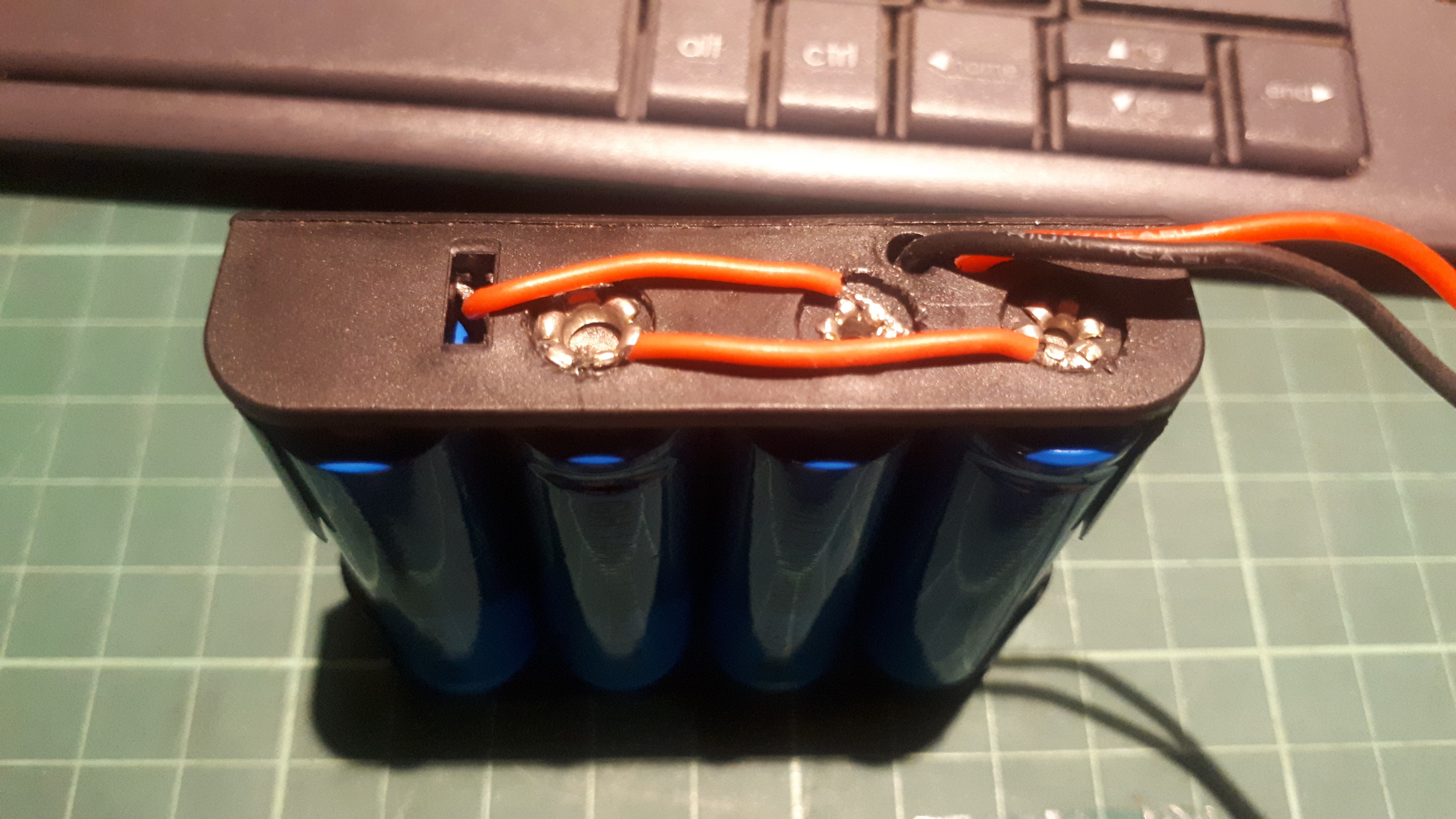

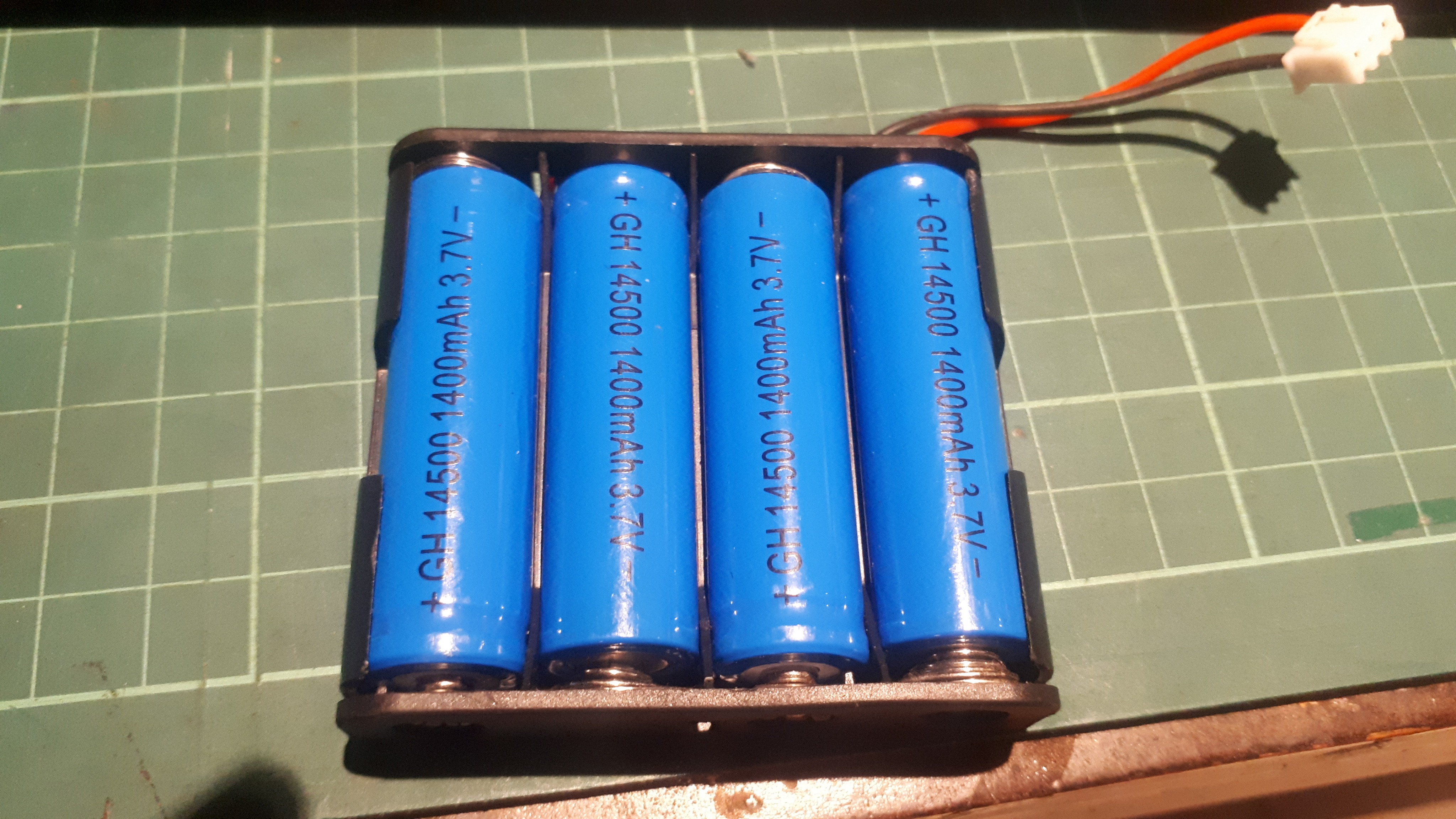

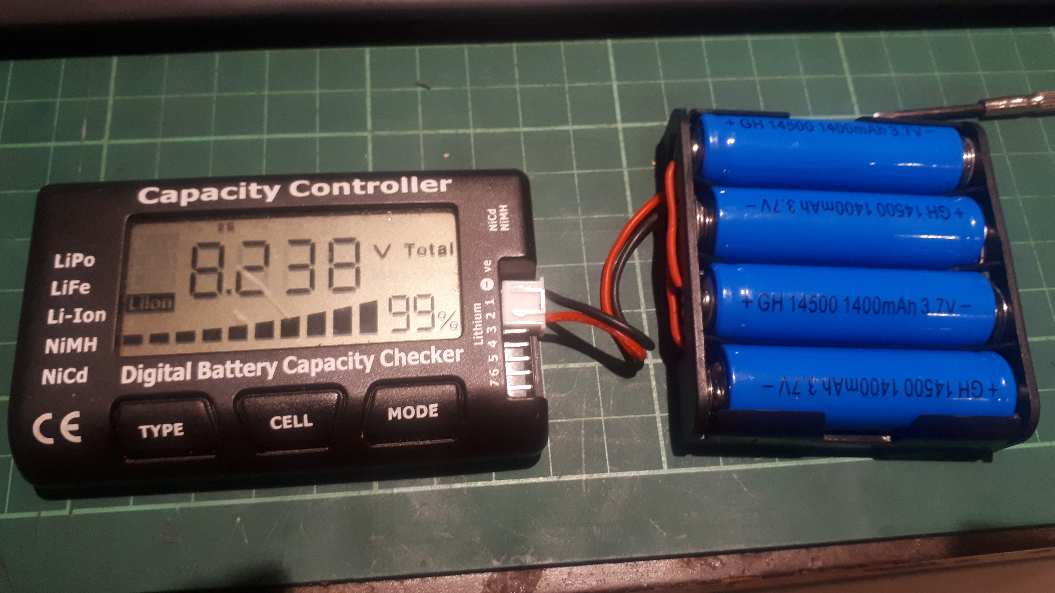

My TX is running on 2S2P config with 4x 14500 batteries.
Just cut the wire joining the left negative and positive terminals (not the black wire running at the back) and attach wire as shown in photo, few light soldering and done.
Only soldered the wire from the far left negative terminal. The rest was clamped down by just lifting the tabs and clamping the wire down.
Alternatively, using the same wiring config, you can also use this with 2S1P by just using the far left and far right battery slots.
A very cheap "upgrade" than finding a lipo that can fit in the slot.
Edit:
You can do without but to add a balance wire, just splice from the black wire at the back or solder to any contacts the wire connects to. I soldered mine to the bottom right negative spring and just ran the wire through the hole with the positive wire.
Replied by Razgriz on topic Jumper T8SG V2 plus transmitter
EDU.WES wrote:
Twilight_Sun wrote:
EDU.WES wrote: It’s easier, cheaper and more capacity.
A 2S 1500 is about $10 shipped. 7.4 x 1500 is 11.1wh
4 x 14500 Li-ions 880mah are $5 shipped. 3.6 x 880 x 4 is 12.6wh. They fit right in the 4 x AA tray
afaik from 4 x 14500 used as 4S battery you will get the same energy delivered to device as from 2 x 14500 because of linear regulator in power input circuit. so more than half of your 12.6Wh will be used for heating up this regulator not for something useful
But if you connect your 4 x 14500 as 2S2P battery working time will be 2x longer
Good idea on the 2S2P, the stock battery tray looks like it will be challenging to modify off of series though
Edit:
