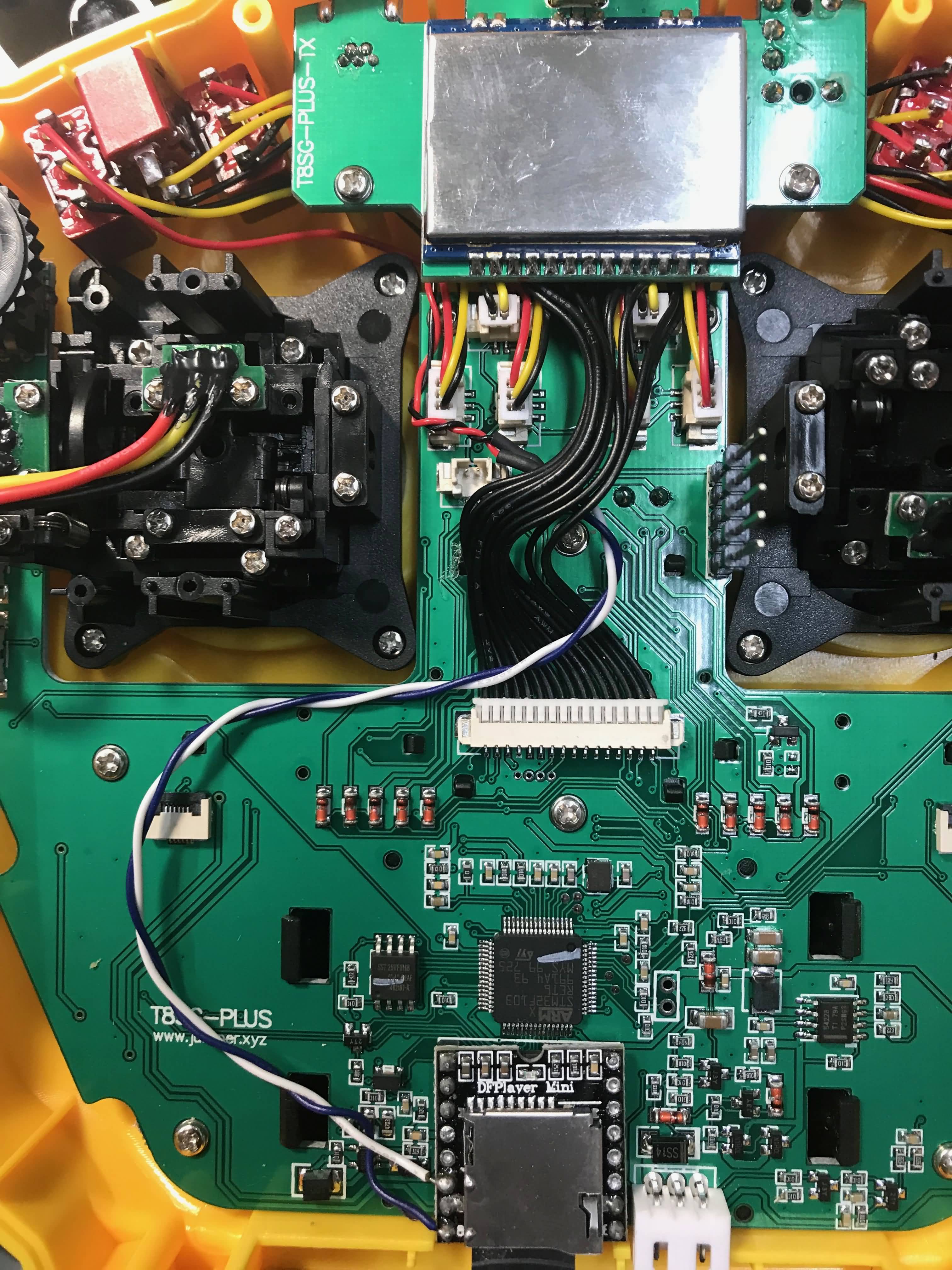

Last night I installed the dfplayer and a speaker I had lying around within half an hour. Everything is will prepared by Jumper as you can see from dc59s pictures, unfortunately you have to disassemble nearly the whole transmitter to solder the pins on the bottom of the pcb, but other than that I really like it. In a quick test there was no jitter using a 2s lipo, but I will further investigate on this issue.
@dc59: can we update the wiki with your pictures from this thread?

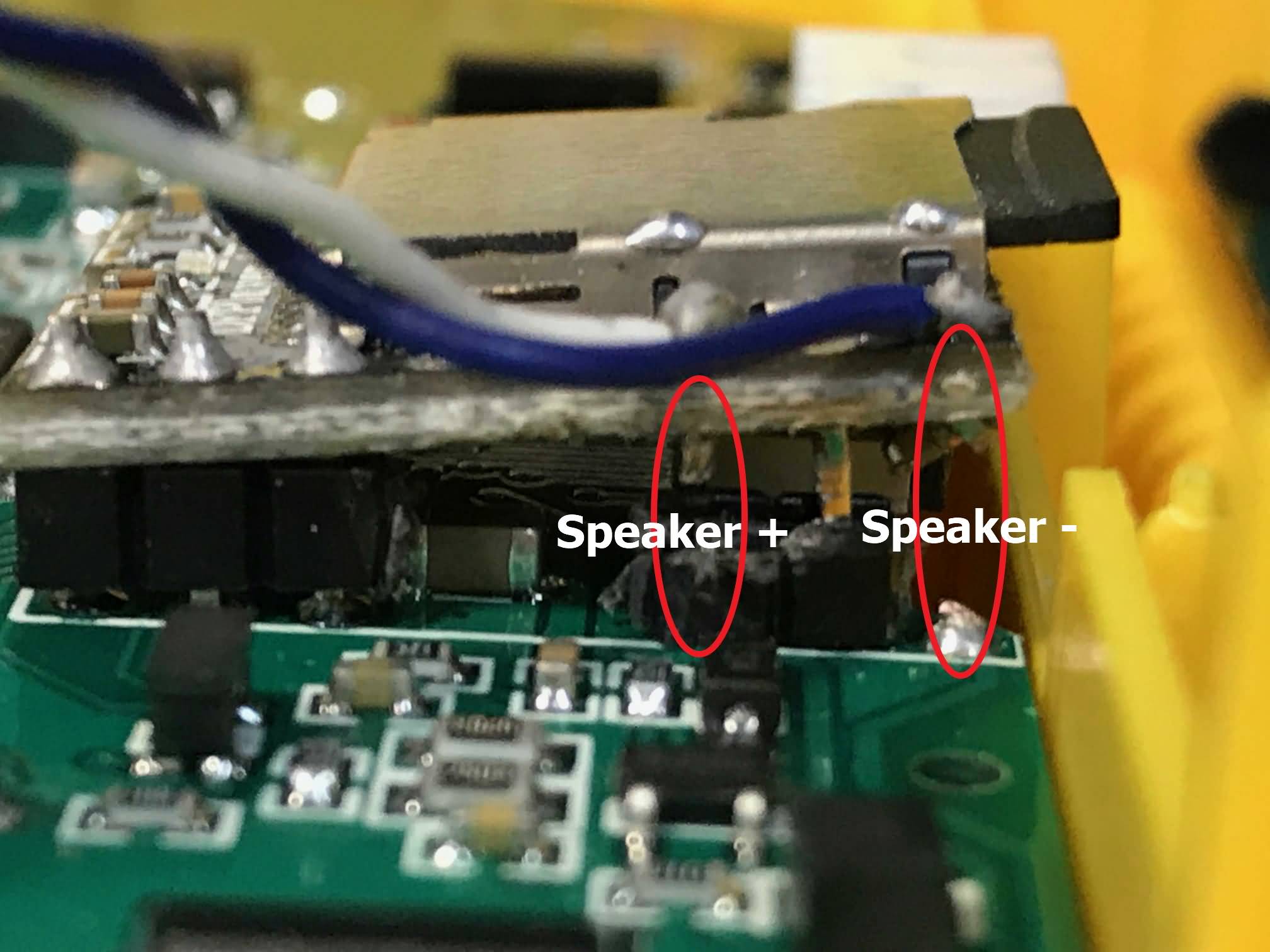

29 Apr 2018 09:26 - 29 Apr 2018 09:28 #68919 by dc59
Replied by dc59 on topic Jumper T8SG V2 plus transmitter
@Moeder,
I have no luck :( , I connect speaker with twist wire to DFPlayer , but I still have buzz noise even if I changed volume to 1 ,
I installed 0.5W 8 Ohm speaker .

01 May 2018 03:59 #68946 by ramunas
Replied by ramunas on topic Jumper T8SG V2 plus transmitter
@DC59- When you installed the twisted wire speaker connection, did you cut the connection of those 2 dfplayer pins to the main board? As I read Moeder's description it seems he totally avoided any connection of the speaker signals to the main board. That could explain the different buzz results.

03 May 2018 13:41 #68993 by dc59
@ Moeder & @ramunas,
Thanks for your help!
I cut speaker pin between main board and DFPlayer , I got very clear voice now , no more buzz noise :)

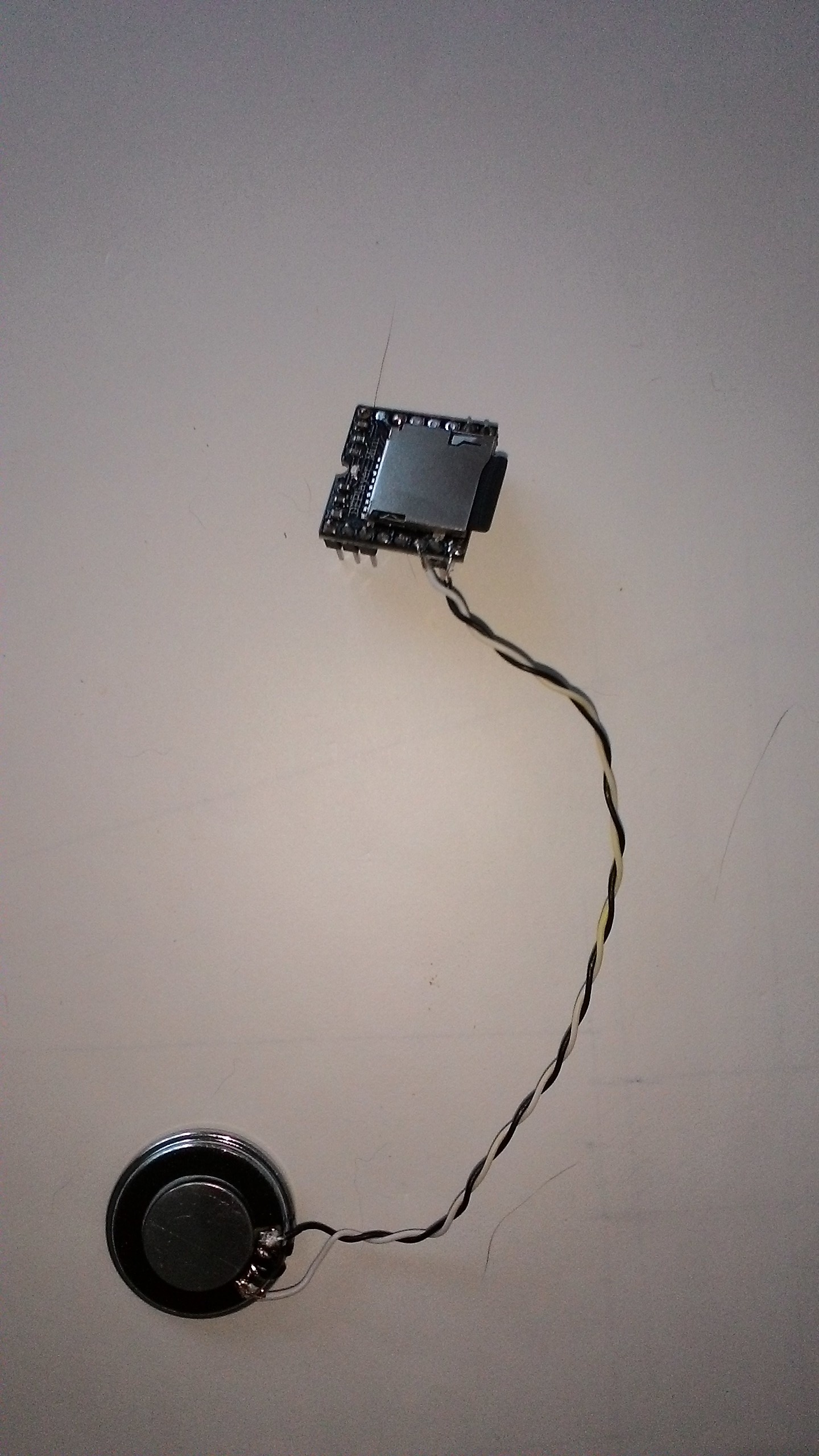

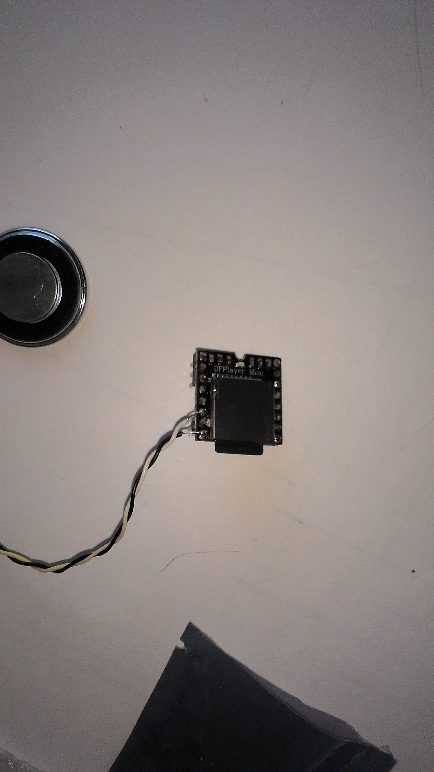

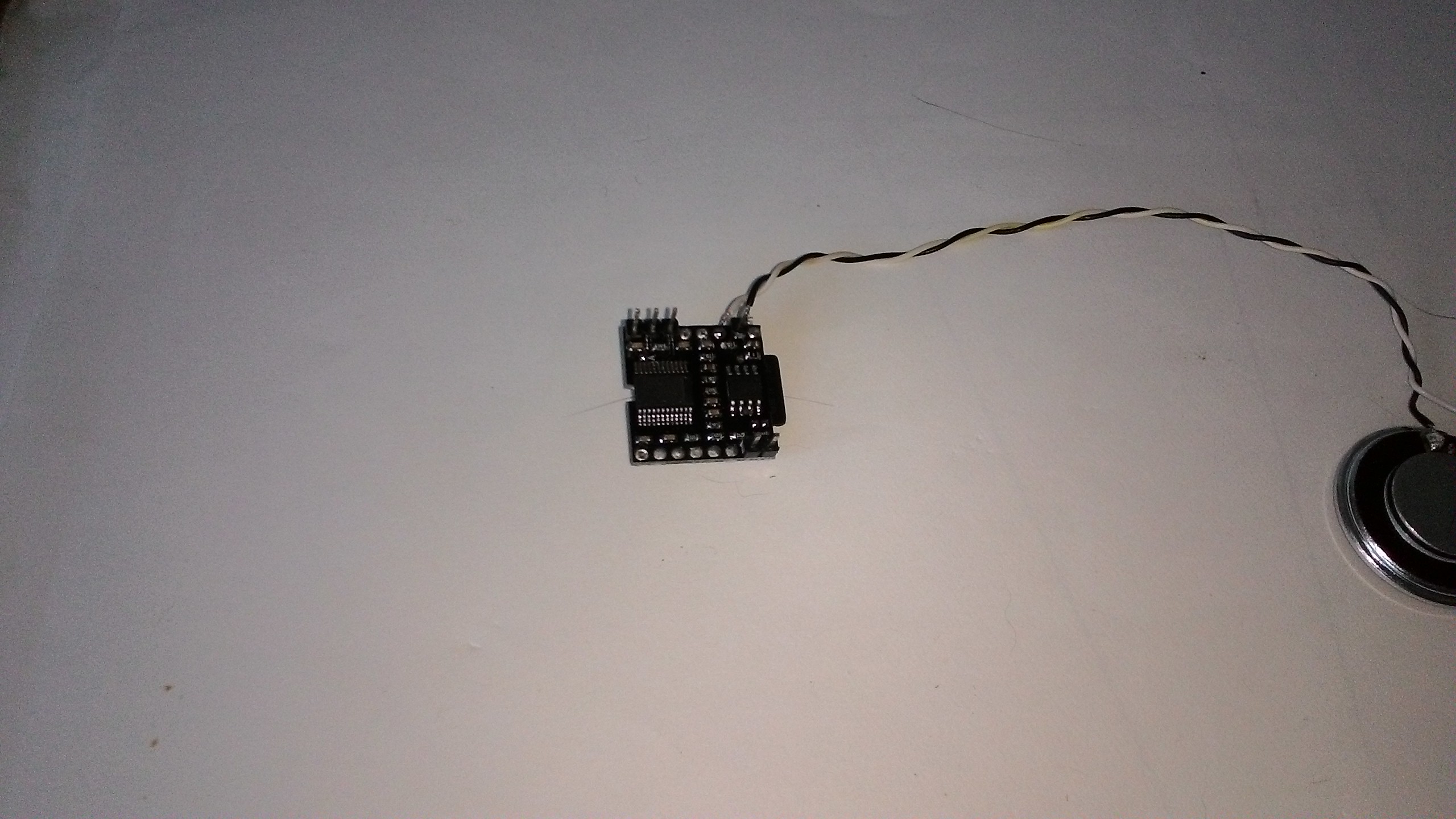

So I tried installing a dfplayer module with direct connection to the speaker.
When using 1.2V rechargeable batteries or 1.5V alkaline batteries, only static comes out of it.
Using 2 cell lipo it played the clips but makes a loud screeching sound initially and later randomly.
Any ideas/suggestions? I did not solder the module in yet, but I don't think that should be a problem.

12 May 2018 09:26 - 12 May 2018 09:26 #69186 by Kecske85
Replied by Kecske85 on topic Jumper T8SG V2 plus transmitter
I don't want to take the tx apart again, the screws are starting to strip, but here is a few pics of the dfplayer module.
I just slid it in to its slot when I was testing.
I did manage to mess up when ordering the speaker, it's a 28mm 8Ohm 1W speaker, could that be it?

12 May 2018 09:56 #69187 by Moeder
Replied by Moeder on topic Jumper T8SG V2 plus transmitter
I see a good possibility of your speaker taking too much current. Try . 3 or. 5 W Speaker
