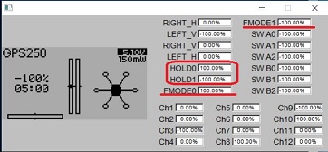

Hi... I'm using the deviation-emu_devo7e-v5.0.0-04f8983 emulator. It's the latest as of today.
I'm seeing the HOLD switch behave as expected but the FMODE switch is behaving differently. The HOLD switch toggles with each input so a complete cycle is hitting the "x" key twice. The FMODE switch, "z", needs to be hit 3 time to complete the cycle.
Steps to reproduce:
1 - I searched through the model.ini file (attached) to confirm that the HOLD and FMODE switches were not assigned to keep this as simple as possible.
2 - Open the emulator and hit the "x" key. The HOLD values will toggle between 100 and -100
3 - Hitting the "z" key will show the FMODE values goes to -100, -100 and 100. It's necessary to hit the "z" key 3 times to cycle.
My purpose is to assign the FMODE switch to the Failsafe function and want it to be completely predictable. Am I doing something wrong or is this a bug in the emulator.
NOTE: On the Devo 7e the switch works correctly but the emulator is a great tool for programming/learning Deviation.
Steps to reproduce:

Replied by vlad_vy on topic Devo 7e: HOLD & FMODE switches in emulator
Try this build:
File deleted...
File deleted...

Replied by MikeNH on topic Devo 7e: HOLD & FMODE switches in emulator
Problem solved... Thank you. That build fixed the problem.
