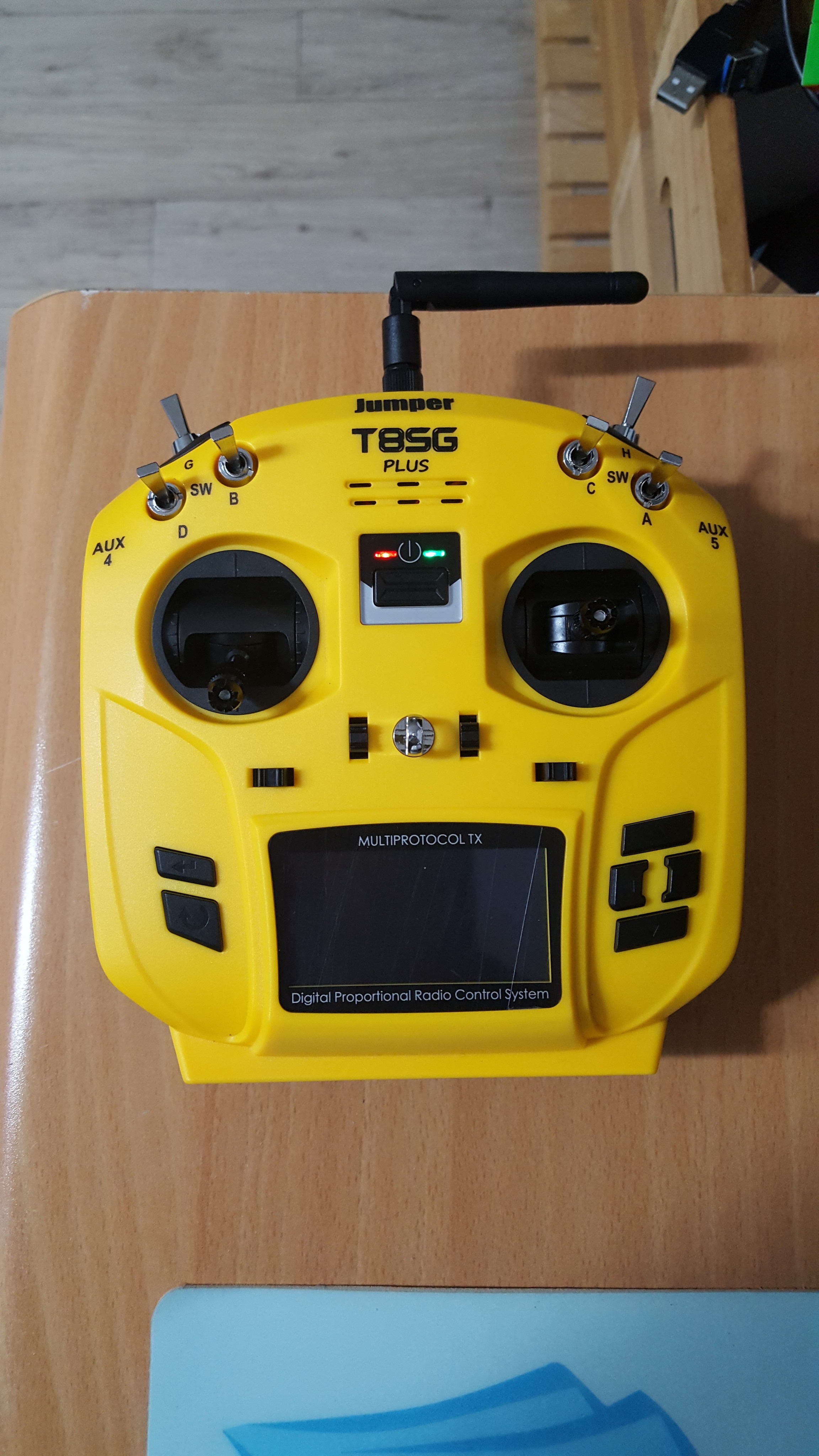

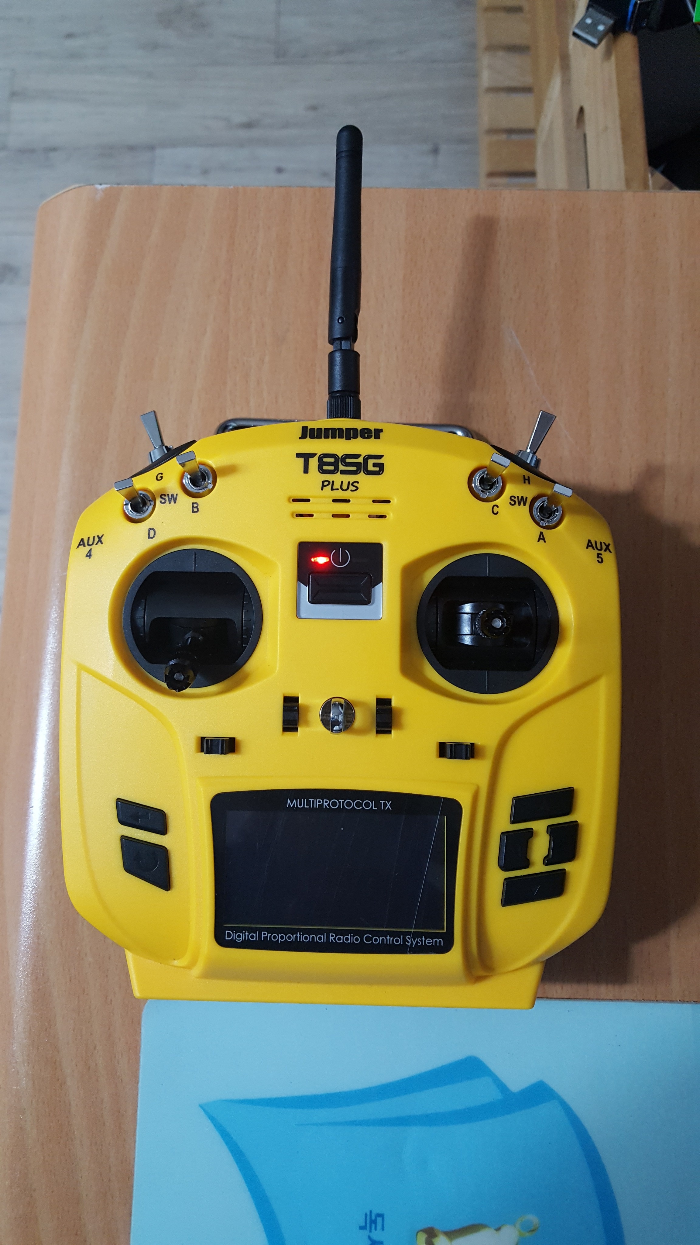

Hello.
I am not good at English.
The red light on the power lamp,
My t8sg plus screen does not turn on.
I can see the usb files on the computer, but the screen is not turned on.
I would appreciate it if you could tell me how to fix it step by step.

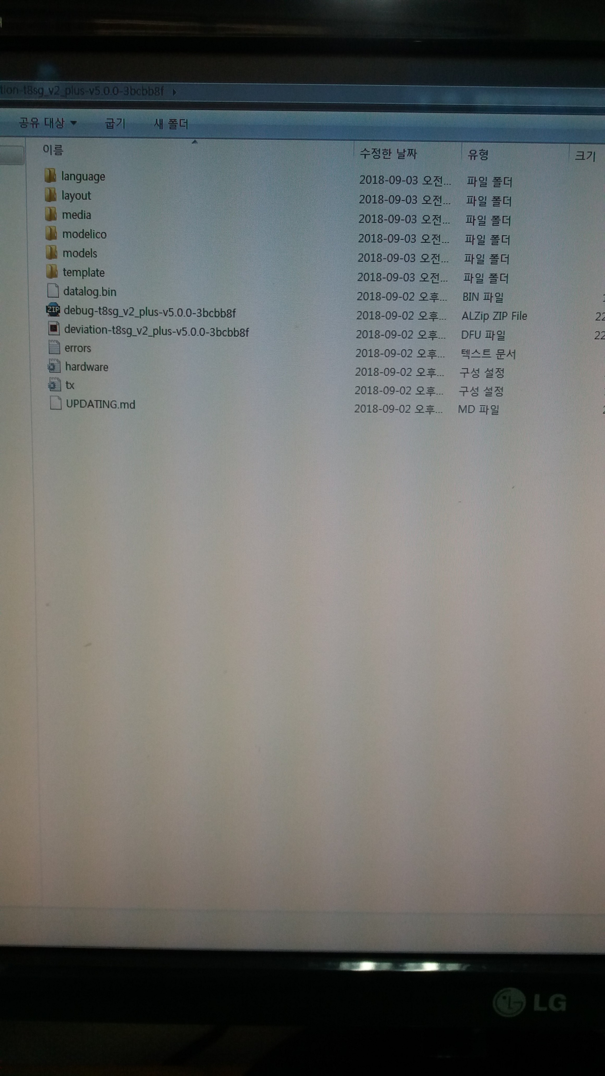

The connection between the computer and the usb mode and the DFU mode is also possible.
There's no picture.
There's no picture.

I appreciated your concerning.
vlad_by
The program installed on my controller is deviation-t8sg_v2_plus-v5.0.0-3bbb8f.
The files are like photos.
There is no "tx.ini" , there is a "tx" file and there is no brightness entry.
vlad_by

04 Sep 2018 06:36 #70633
Replied by vlad_vy on topic Jumper T8SG PLUS stopped working
It is "tx.ini", but you have "do not show known extensions" option enabled.

So you have default "tx.ini", and by default "brightness=5". It looks like you have some hardware problem. Try reseat LCD flat cable. There is the plastic latch on LCD connector, lift it.

I would also check if the ribbon cable connecting the display to the main board is properly connected, might be a very simple fix ...
- mercury9
- Posts: 10
05 Sep 2018 02:09 #70652
by mercury9
Replied by mercury9 on topic Jumper T8SG PLUS stopped working
The ribbon cable was completely disconnected from the main board and reconnected but the screen was not visible.
